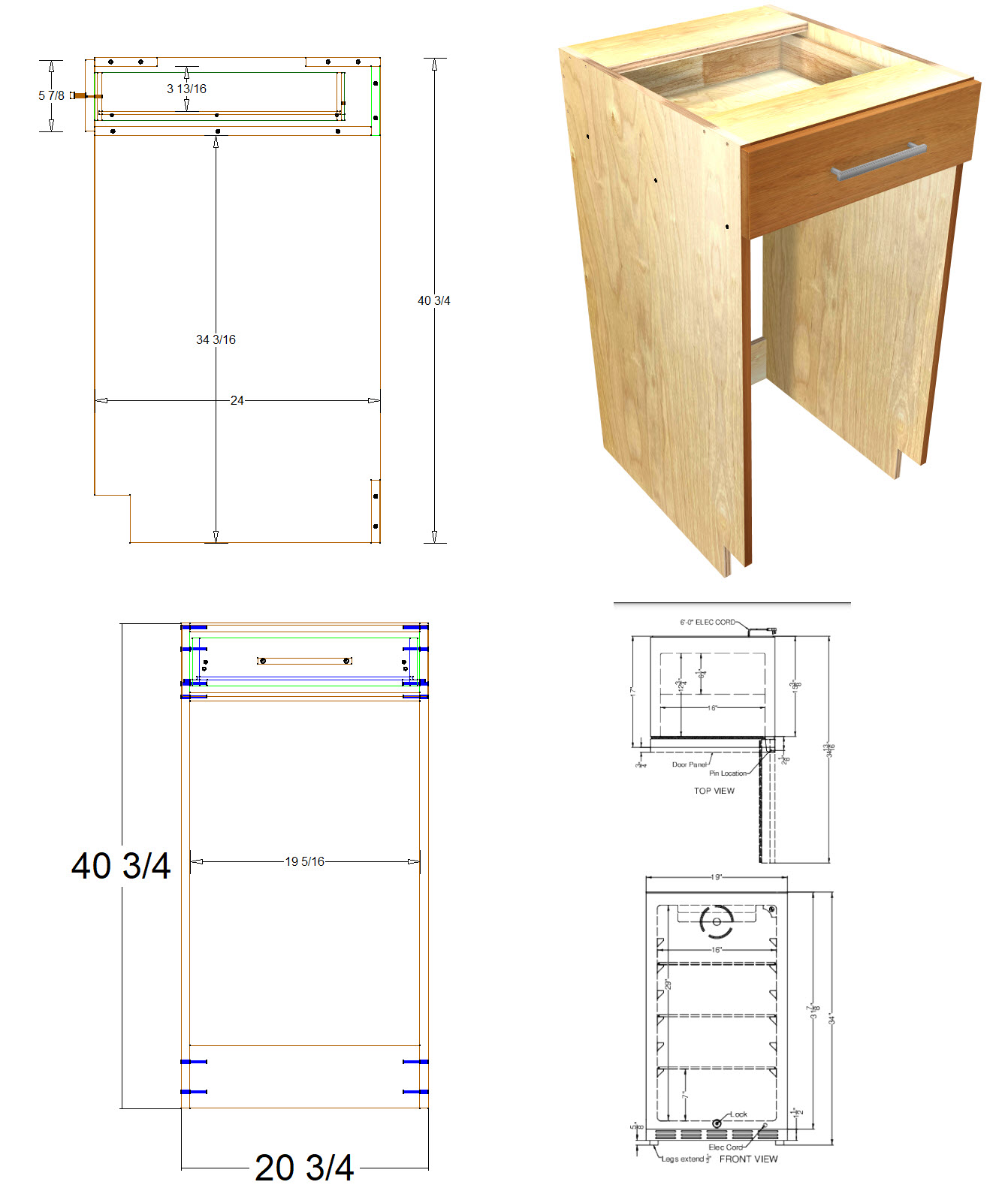

  • in reply to: Does an appliance case top drawer match 1D bases? #1306
      Sure, so when using this cabinet, you will have a 5 7/8″ tall top drawer front as a standard. T his top drawer front height is standard as it will align with other top drawer fronts.
      https://www.barkercabinets.com/Base-1-Drawer-Appliance-Case-p/b1drappliancecasetall.htm
      Looks like that ref is 34″ tall, so I would suggest ordering that cabinet at 40.75″ tall to ensure you have a bit of extra space in the opening height.
      ref
