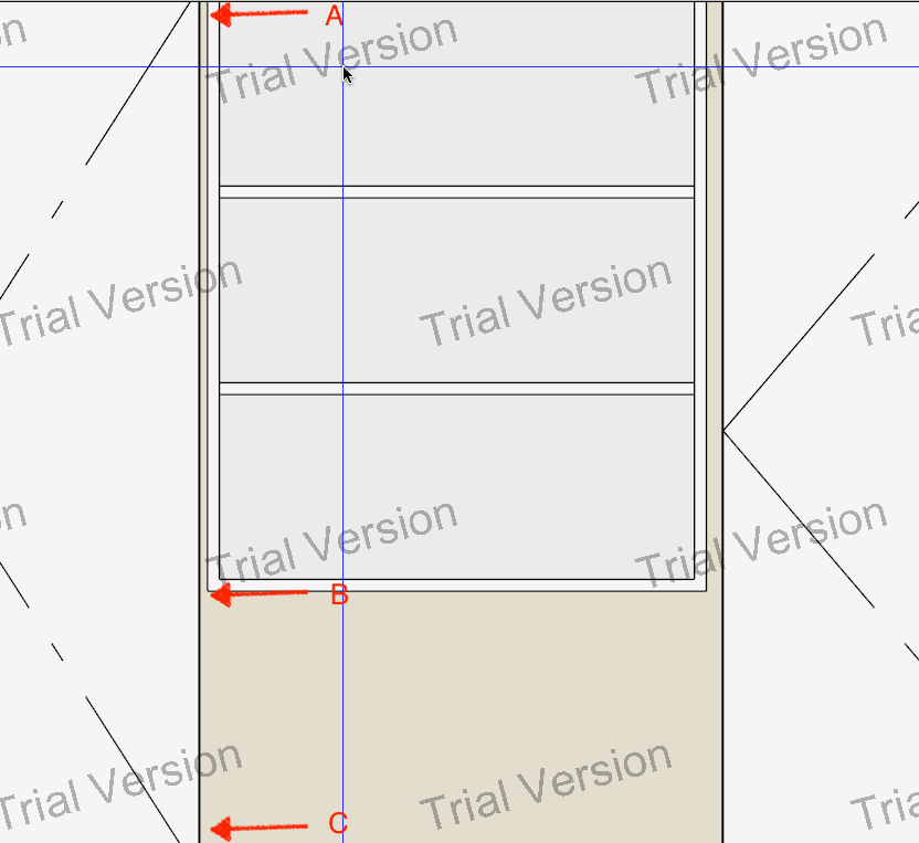

    I am learning to use the trial version of Chief Architect to design kitchens, bathrooms for my home.
    I am planning for an open exposed wall cabinet at higher elevation than the adjoining side cabinets for above the kitchen sink.
    My question is should the WFE I order cover entire side of cabinet (A to C) or only the exposed side of cabinet (B to C)?

    You can do it either way, but typically we would run the finished end panel full height from A to C. This creates a separation between the exposed and standard cabinet styles.
