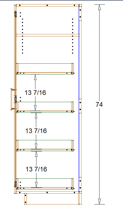

    Sure, with four rollouts, you would end up with something like this:

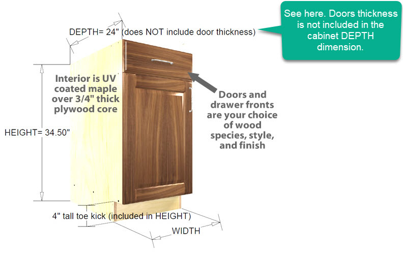

    Hi – thanks for all of this. Love your cabinets in my kitchen – but can’t remember how I ordered the depth.
    I’m using kitchen wall cabinets in a different part of my house — does the depth measurement include the door? So if I order a 15” depth door (shaker) is the final 15 3/4”?
    January 20, 2026 at 12:34 pm
    Sure. The cabinet DEP[TH dimension does not include the cabinet doors depth. Cabinet depths are always of just the cabinet case the doors are attached to.
