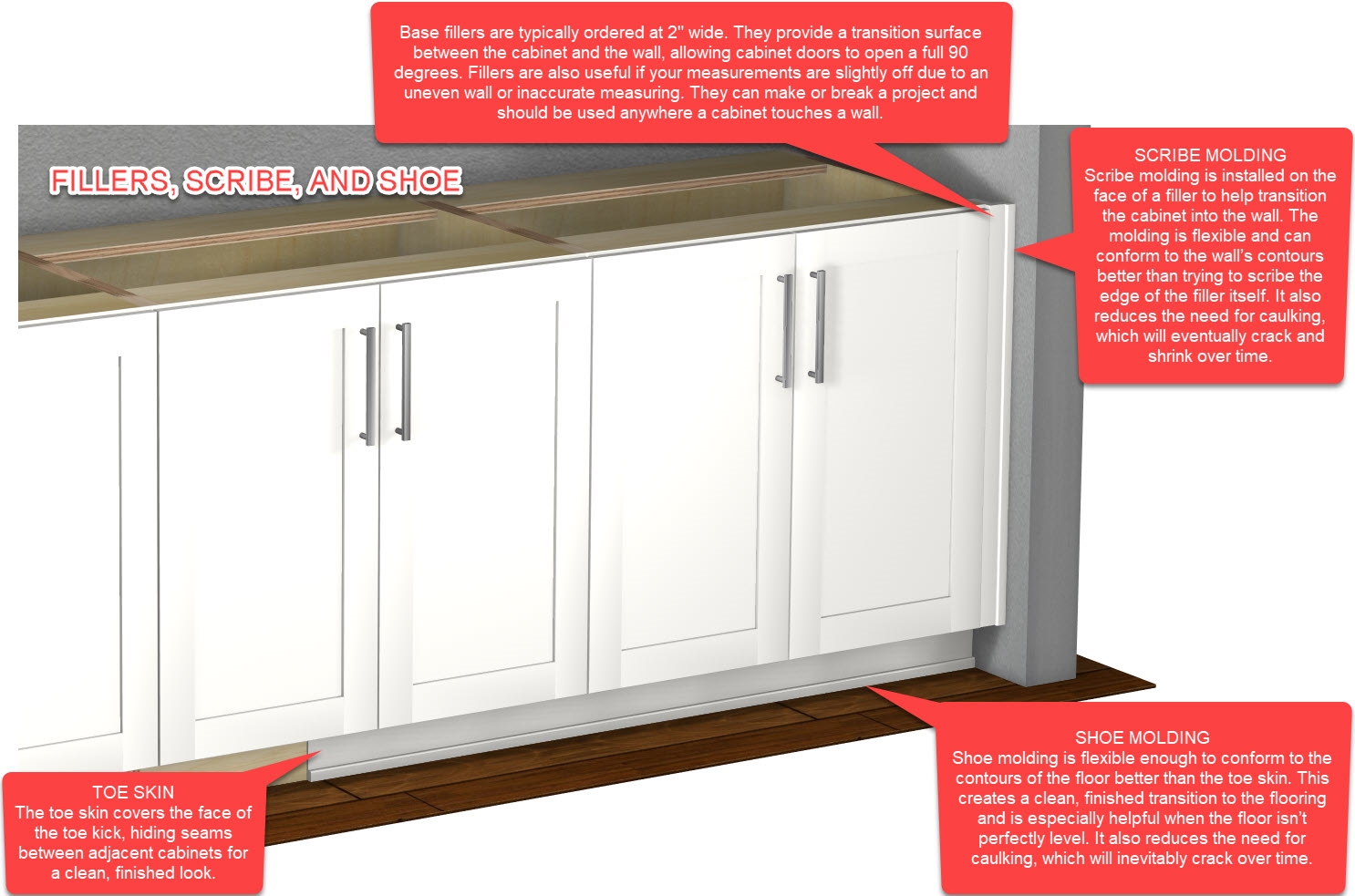

    Will need 2 90″ toe skins, where should seam be? at seam between 22″ cabs. Also base shoe to cover bottom of toe skins, same question about seam.
    I assume I’d get 2 76.5″ 2″ wide spacers and two 30.5″ 2″ wide spacers for lower cabs to toe kick level. Trim existing 5-6″ baseboard to fit. How do you fill the hole left where toe kick ends? Miter pieces of filler? How much extra 2″ filler should I buy?

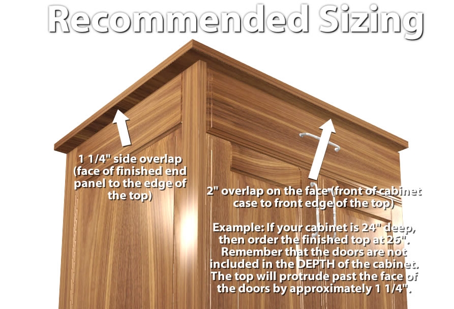

    Also need finished top over the 2 22″ cabinets. Should this abut or run underneath the side finished ends? Should this overhang the 22″ cabinets? This will NOT be a work space so won’t get wet. If run under the finished sides tall cabinets, then 44″ wide I think and if abutting them, reduce by the combined thickness of the side finished ends??

    Also, how much scribe should I buy? And where should it be placed?

    Sure, when finishing the sides of the cabinets and covering the visible construction holes, we always recommend using a 3/4″ thick finished end panel. We also offer a 1.5″ thick plywood end panel, but that thickness is typically only necessary for island applications.
    Finished countertops should overhang the finished end panels by approximately 1–2″. Refer to the image below for a visual guide on how we recommend installing them.
    Scribe and shoe molding are extremely useful for tying cabinets cleanly into the walls. Both are inexpensive and make the project look more professional, so we always suggest ordering more than enough to use on all fillers and toe-kick areas.
    Seams can be placed wherever you prefer. Any run longer than 90″ will require at least one seam. If the material is painted, you may fill and paint the seam if desired, but doing so is not required. Ideally, locate seams in low-visibility areas, where they’re least noticeable at eye level.

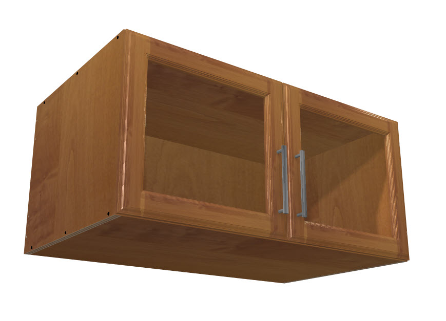

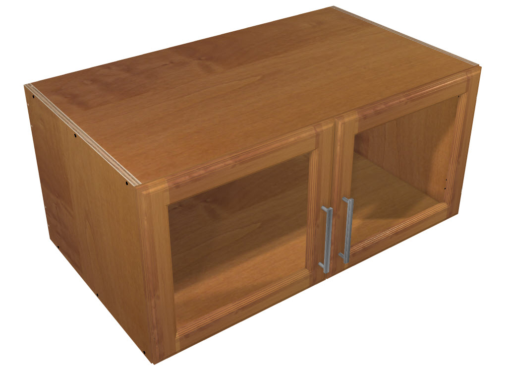

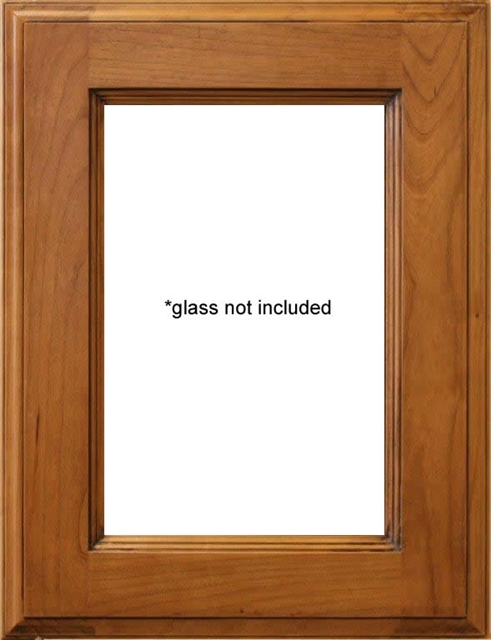

    Glass from cabinet, as below: What would door look like?
    2 glass door wall cabinet (interior will the match wood type and finish chosen for the face of the cabinet)
    [WIDTH:42.00″][HEIGHT:19.50″][DEPTH:24.00″][Door/Drawer Front Style:Oregon Raised Panel][Door/Drawer Front Wood Type:Alder (premium select)][Grid Glass:standard glass door][Door/Drawer Front Prefinishing:ESPRESSO (custom dark stain)][Cabinet Case Material:wood species will match “Wood Type” and “Finish” chosen above]
    December 18, 2025 at 11:23 am
    Sure, the cabinet and door profiles will look like these images. Note Espresso is not shown.

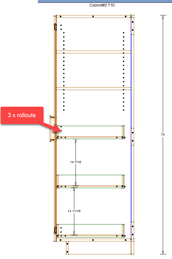

    For 74″ tall pantry cabinet, how many fixed shelves if I order 4 roll out shelves vs 3 vs 2 rollout shelves. Approximate height from ground for rollout shelves. Wife is 5’2″ so high rollout shelves aren’t helpful.

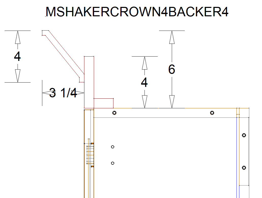

    How far horizontally does the 4″ Portland crown molding extend?
    What is minimal clearance between wall and pantry double door cabinet for the rollout out shelves to clear? Our current layout is 1 3/4″.
    January 5, 2026 at 12:37 pm
    Sure, please see the attached for an example of how rollouts are typically laid out in a 74″ tall pantry. This can vary slightly depending on who is completing the layout in our office, but this is a close representation of what you can expect. We do our best to evenly distribute the spacing between shelves and rollouts for a balanced, functional layout.
    If you are looking at the Portland Crown that is about 4″ tall, then that crown is about 3.25″ deep from front to back. See attached.
    https://www.barkercabinets.com/product-p/mportlandcrown4.htm
    https://www.barkercabinets.com/product-p/mportlandcrown4backer4.htm
    As long as the pantry doors can open to 90 degrees, the rollouts will operate properly and clear the doors without issue. Including a 2″ wide filler between the wall and the pantry provides added flexibility and ensures the doors can open fully to 90 degrees.
