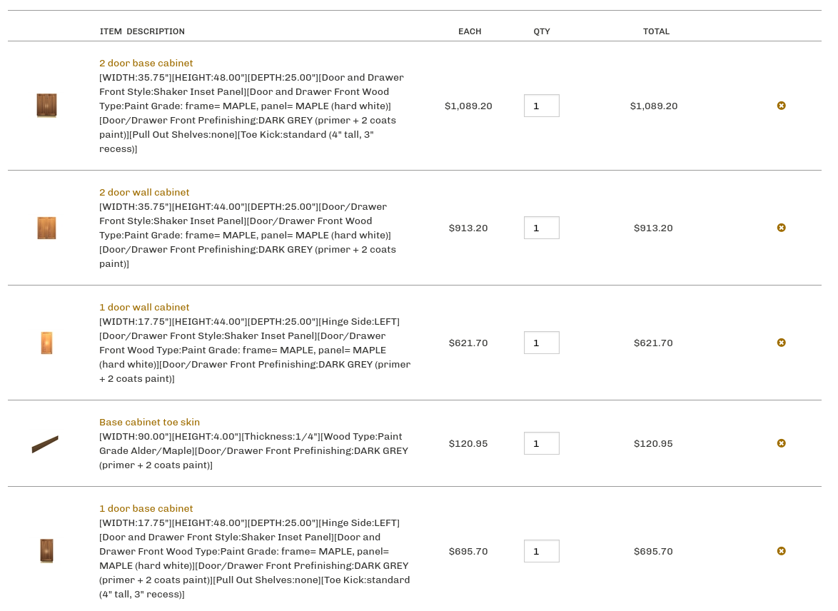

    I’m planning a floor-to-ceiling linen cabinet build using two sets of stacked Barker cabinets in an alcove.
    The Setup:
    Bottom: One 35.75″(2-door) and one 17.75″(1-door) wide base cabinet (48″ H x 25″ D).
    Top: One 35.75″(2-door) and one 17.75″(1-door) wide wall cabinet (44″ H x 25″ D) stacked directly on the bases.
    Style: Shaker Inset doors with a factory-painted finish.
    Questions:
    1. Vertical Door Clearance: Since these are Full Overlay doors stacked directly on top of each other, is there a high risk of the upper doors rubbing against the lower doors at the horizontal seam? Should I plan to leave a specific gap or use a small spacer between the upper and lower boxes during assembly to maintain a clean reveal?
    2. Structural Stability: These 25″ deep wall units will be quite heavy when loaded. Over time, is there any concern with the weight causing the cabinet boxes to settle or compress in a way that “pinches” the vertical gap between the doors?
    3. Support: For those who have stacked these deep units, did you find that standard wall-stud mounting provided enough support, or did you reinforce the connection between the stacked boxes?
    Any advice on ensuring the doors swing freely without horizontal interference would be greatly appreciated!
