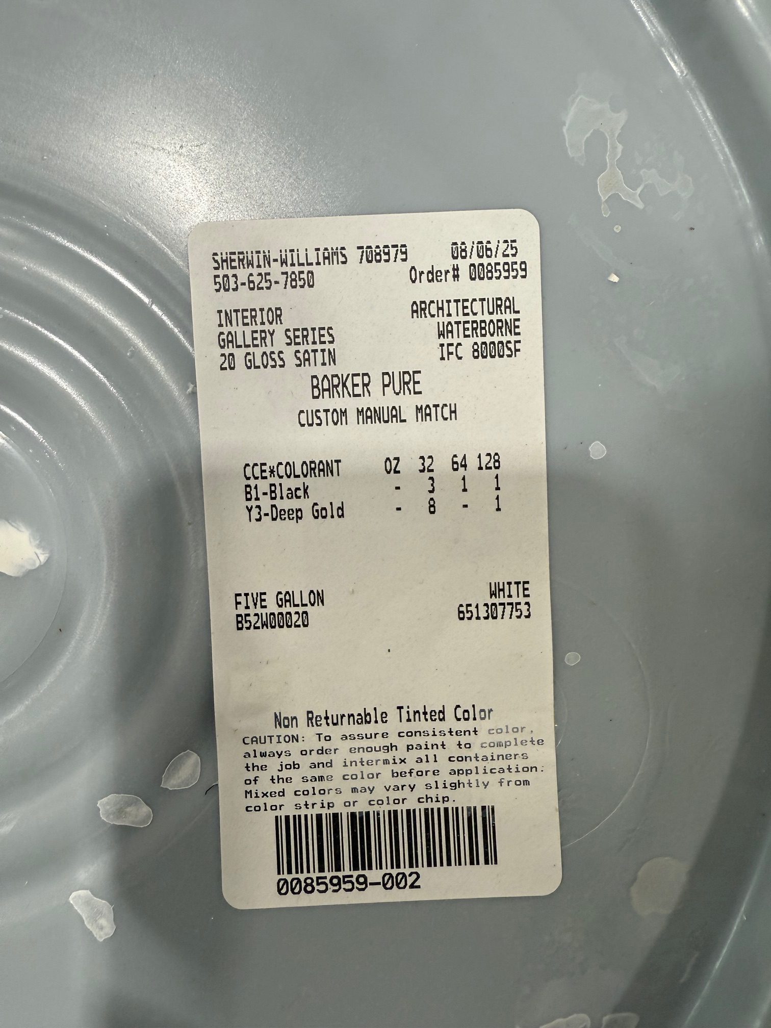

    We need to refinish some end panels that came pre-finished from Barker in Pure White (satin).

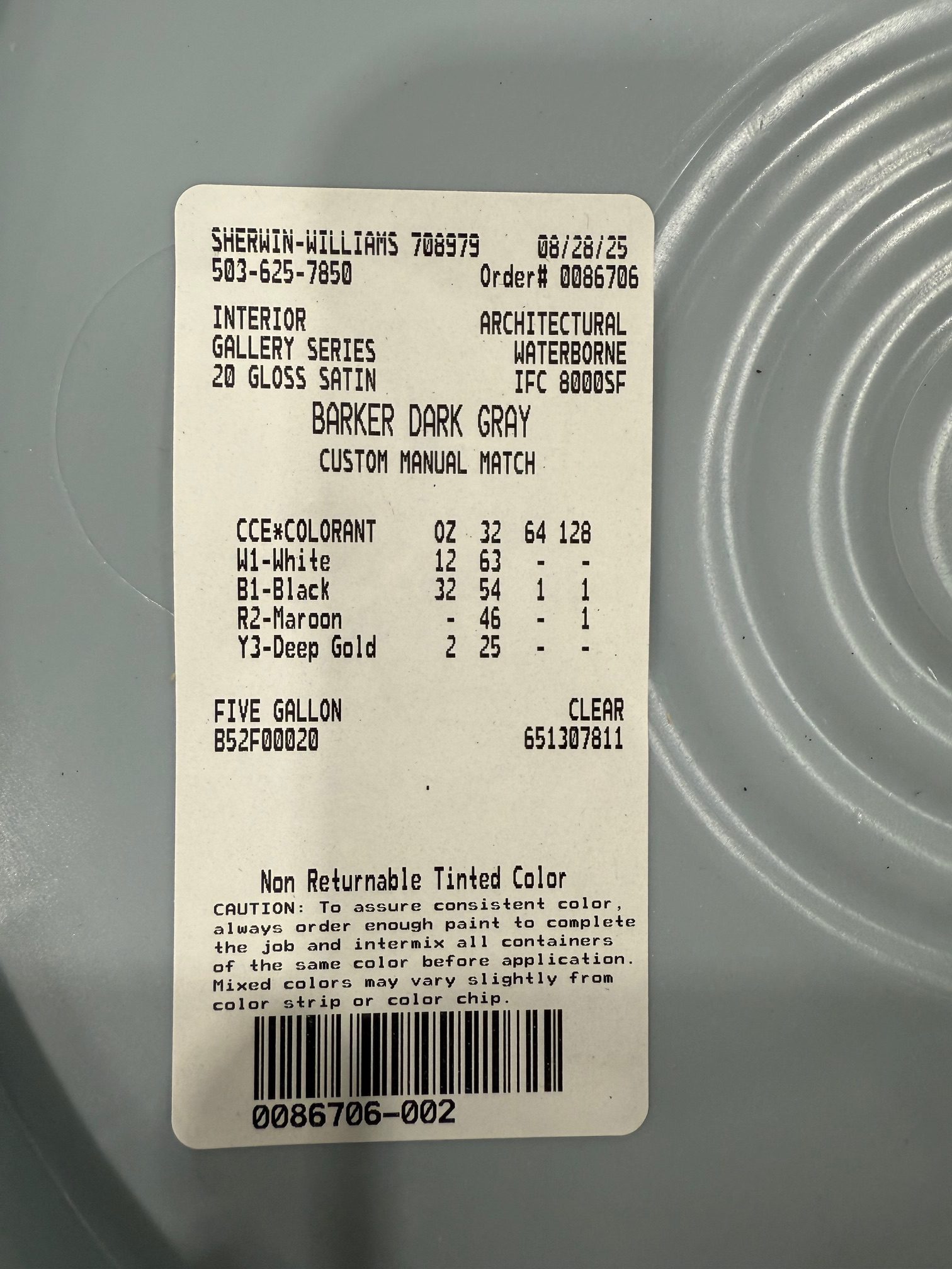

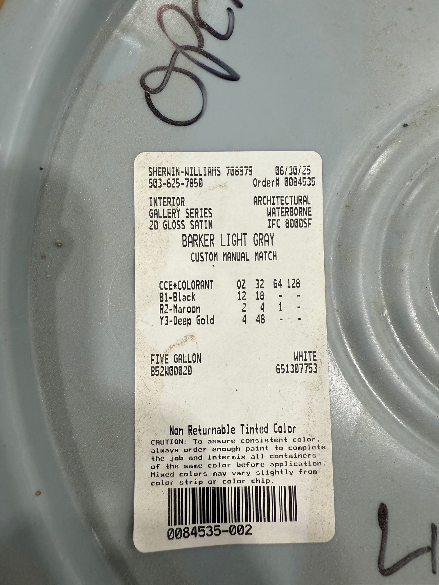

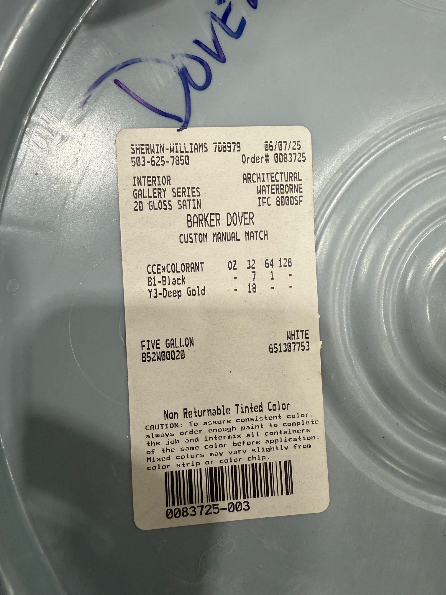

    Sure, we have a color match that works well. I use Sherwin-Williams Gallery paint with a 20 sheen. This is my go-to when matching Barker Cabinets’ painted conversion varnish finish for on site repairs without having to reorder a new piece or take it back for a repaint. While it’s not the exact same formula and cannot be a perfect match (water based versus Conversion varnish will always look and feel a bit different), it’s about as close as you can get before you start second-guessing whether you even see a difference, so it’s very good.
    I recommend priming the entire face and painting the whole side, even if you’re only repairing a couple of holes. Use a Sherwin-Williams Gallery primer first, then apply a topcoat with the attached formula. I’ve tested applying this paint directly over conversion varnish, but I don’t feel the bond is strong enough due to the difference in chemistry between the two coatings.
    You can always attempt a local touch-up repair; if it looks good, you can live with it. If not, apply both primer and paint over the conversion varnish and you’ll be set. Keep in mind that Gallery is a spray-only finish, so your results may vary depending on your application method.
