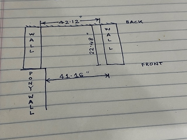

    The space where the pantry is to be located is 42.12w x 22.48d. We have pony wall as see in the attached picture which reduces the effective opening to 41.16 in. I have designed with a pantry that is 36w x 20d. I have attached a couple pictures of chief arch.’s plan view and rendering, but it does not show the pony wall. I tried adding the pony wall through CA, but it did not quite work out. At this time we don’t intend to remove the pony wall.
    In that case: Would 36w x 20d be the max possible pantry or could I make it wider, deeper and possibly reduce the fillers?
    Thank you.

    I like the way you have it with 2″ wide fillers on each side. Fillers are very important and help make the installation look custom and built into the space.
    You can reduce them if needed, but anything smaller will make installation more difficult. A 2″ filler works well because it allows you to add a piece of scribe molding on the face to cover any irregular gaps between the filler and the wall. This is ideal since it eliminates the need for caulking, which tends to crack and fail over time.
    The scribe is about 3/4″ wide, so it will cover the gap nicely while still leaving enough exposed filler face to look balanced. This avoids crowding the face too much or drawing attention to the scribe as it follows any unevenness in the wall.
