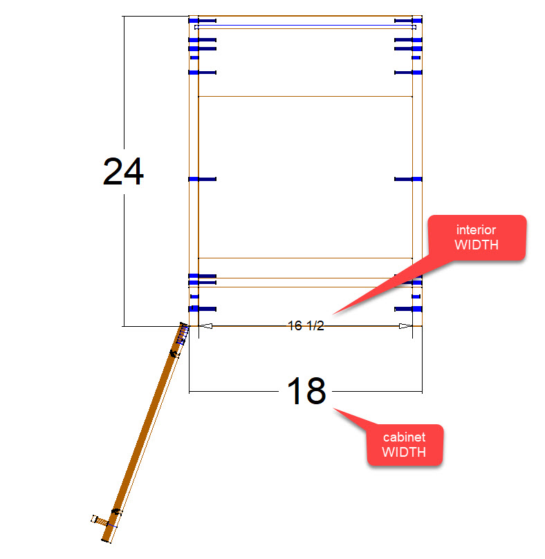

    I am trying to determine the interior width of base cabinets. if the cabinet is an 18″ base cabinet – frameless – what is the width of the INSIDE of the cabinet? I need to determine exact measurements so that I can find trash rollouts that will fit.

    Cabinets are constructed from 3/4 inch thick plywood. On an 18 inch wide cabinet, the two side panels account for 1 1/2 inches total thickness. This results in approximately 16 1/2 inches of interior usable width.
