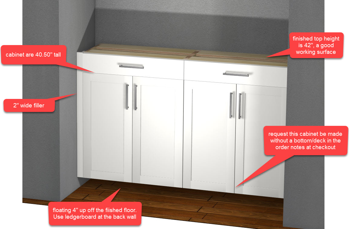

    Based on what I’m seeing in the robot garage thread, I see that I can order a base unit with no toe kick. Which means I could probably use two 2-door pantry tall cabinets at 33-34″ wide x 60″ tall x 16″ deep. I can put a ledger board around the base and use that for some support as well as mounting them to the wall. Let me know if that’s the right approach.
    While that seems like it might be a good option, that specs out to be $1,900 per unit, $3,800 for the pair. Then more for the top part. So probably close to $5K for that one wall. It’s obviously an expensive wall but I need uppers above my washer & dryer across from this wall, base cabinets in the pantry, 15′ of base cabinets in the dining room, and 17′ of base cabinets in the living room. I knew there was a reason I’ve been putting this off. The good news is that I can get everything custom and not have to work around the limitations of other options.
    October 28, 2025 at 12:19 pm
    Yep, that’s exactly how I’d approach this. I’d use a ledger board along the back wall and order the base or tall cabinets without a toe kick. That way, you can float the cabinet stack at whatever height you prefer.
    For budget reasons, consider starting with just a base run of cabinets at a 42″ finished countertop height (which means the cabinet height without the top would be about 40.5″). I love a 42″ working surface — you’ll always find it useful as a convenient workspace, especially in a utility room.
    Tall pantry stacks are the most expensive from a material standpoint, so start simple: install a line of base cabinets now, then add wall cabinets later as needed. This phased approach lets you expand over time without the full upfront cost.
    If you’re looking to save even more, our City line is perfect for this application. It offers the same look and design as Barker Cabinets, but uses imported ¾” plywood instead of domestic material. It’s every bit as strong, if not stronger, just not sourced in the USA.
