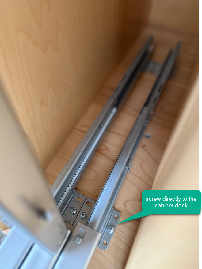

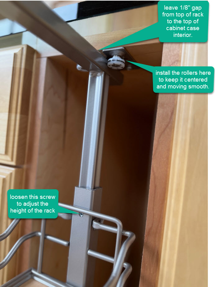

    If you reduced the cabinet height to 34.25″, that’s perfectly fine. The pullout slim rack includes Allen-wrench set screws that allow you to adjust the height up or down by a few inches to accommodate variations. The rack should always be installed directly on the cabinet deck, without any additional 1/4″ fillers underneath.
