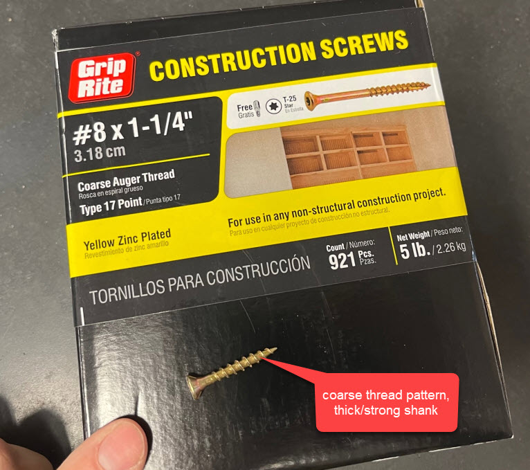

Home › Browse Forums › BARKER CABINETS › Finished End Panels BARKER CABINETS Finished End Panels Posted by Scott Finlay on September 18, 2025 at 8:40 am What is the recommended method for installing the finished end panels on wall cabinets? Chad replied 10 months, 1 week ago 1 Member · 2 Replies 2 Replies Lon Guest September 18, 2025 at 8:55 am 1 used 1 1/4″ cabinet screws from the interior of the box into the four corners of the end panels. Chad Administrator September 18, 2025 at 1:28 pm For screw selection, I usually use these screws that are available at Home Depot. Legacy attachments: screws-recommended-for-cabinet-installation-and-end-panels Reply Reply to: Scott Finlay What is the recommended method for installing the… Cancel Your information: Name (required): Email (will not be published) (required): Website: Cancel Discard Draft Post Public All Members Only Me PublicAll MembersOnly Me Public All Members Only Me Reply Start of Discussion 0 of 0 replies June 2018 Now
