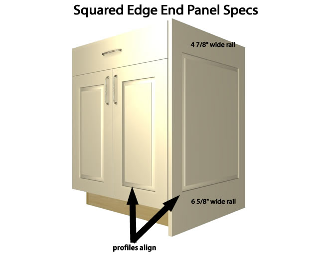

    What are the side and top rail measurements for a Finished End Panel with Squared Outside Edges (Shaker style)?

    Sure here for for the specs:

      Does the bottom rail measurement of 6 5/8 assume a 34.5″ overall height? So any reductions in height would reduce that measurement accordingly? Also what about the stile width on the sides? What is that measurement?

    The bottom rail is static at 6 5/8″ tall. It will not change at all even if the height of the cabinet changes. Same for the top rail, it stays at the 4 7/8″.
