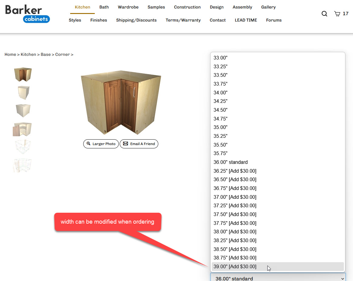

    I have a kitchen wall that is 60 inches from corner to door.
    I want to put a 90 degree 36 inch corner base and a 19.25 inch dishwasher appliiance base with finished end panel.
    If my calculations are correct there wwill be a 4 inch space between the 2 cabinets.
    What are my options to fill/enclose the 4 inch space?

    Order the Base 90 cabinet 4″ wider, for a total width of 36″. You can leave the depth as is or modify it as needed to match adjacent cabinets—having different width and depth dimensions will not be visually noticeable.
    Since our cabinets are fully custom and built to order, you may also order that Base 90 cabinet at 40″ wide or deep, even though the website shows a standard/default size of 36″ wide and deep. If you only see 39″ listed as the maximum online, simply order it at 39″ and include a note at checkout requesting the exact final dimension you want.
    Please be sure to include the order note; otherwise, the cabinet will be manufactured exactly as ordered on the website.

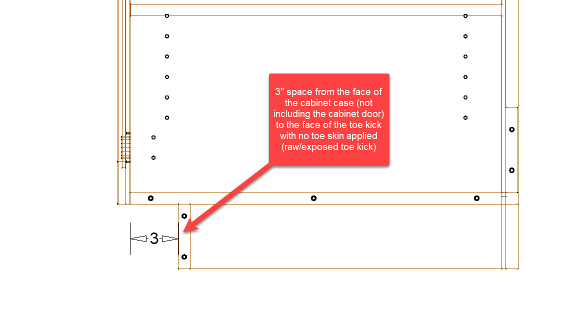

    What is the distance from the front of the face frame (of a kitchen base cabinet) to the front of the vertical surface of the toekick? Thanks, Dario
    December 29, 2025 at 12:33 pm
    Sure, the standard toe kick is recessed 3″ from the face of the cabinet. See here:
