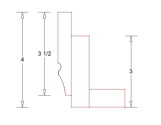

    If we wanted to, I assume we could rip down the height of the 3.5 inch buildup molding to say 2 or 2.5 inches and bring it to the ceiling.
    Do you happen to have any images of what the front profile of the buildup molding looks like?
    March 24, 2025 at 2:31 pm
    Sure, the build up molding is rather easy to cut down in height. I will see about getting some pics showing it in real life.

    April 1, 2025 at 11:07 am
    Apologies for the delay. Just returned form vacation.
    See these images. Is this what you are thinking?
  • mikehuhn
    April 1, 2025 at 4:59 pm
    Yes, that was the idea … something to combine with the flat crown backer to be able to float along the ceiling.
    The 3.5 inch buildup looks like it could be a great option for a flat crown with some further visual interest!
