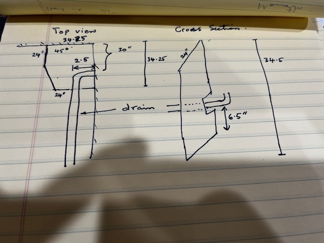

    We have kitchen drain as shown in the attached image. We are thinking of having a base corner 45 and potentially a 3 drawer cabinet – [ B45 | B3DR | SINK ]. With regards to this the questions I have are:
    1) The cabinets would be 24 in deep. The drain pipe is about 2.5 in from the wall. Would the drawers have a depth of 21 in, such that they are not obstructed by the drain pipe?
    2) As the drain pipe run across cabinets [ 45 base corner | 3 drawer base | 2 door sink ], we would need to create cut-outs in the side walls of the cabinets. Would this be ok? (Please see attached picture for the cross section view of one of the walls.)
    3) What is the size of the opening of a 34.5 in x 34 in x 24 in x 24 in 45 deg. base cabinet?

    March 3, 2026 at 11:57 am
    1. How high off the floor is the drain pipe? In theory, you could run the drain pipe underneath the cabinets. There is a 4 inch space below the cabinet boxes that is not used structurally, so it functions as a void that can be utilized if needed. Most black ABS drain pipe is approximately 2 inches in diameter, so clearance should not be an issue.
    2. Yes, you will be cutting into the rear of the UER or UEL cabinet sides. That is perfectly acceptable. You can remove material from those areas as needed, provided you shim the cabinets properly in a few locations to maintain adequate countertop support. The cabinet sides are 3/4 inch thick. When cabinets are installed side by side, you effectively have 1 1/2 inches of solid plywood. Even with material removed for the pipe, the structure will remain more than strong enough to support a heavy load.
    3. Refer to the attached CAD image for a top view. A 34 inch by 34 inch Base 45 cabinet with 24 inch returns will provide approximately a 13 1/8 inch door opening behind that door. The hinges will slightly reduce usable clearance, but this gives you a general idea of the available space.

    The drain is 6 inches above the bottom of current base cabinet. That would make it about 10 in above the floor. So, doesn’t look it could be concealed. The outer edge of this pipe is 3 in from the wall. So, I am concerned that will obstruct a drawer. Having a B3DR here would be great but considering the measurements is it possible to reduce the depth of the lower most drawer?
    Thank you for the dimension on the opening of a B45 corner cabinet. Effective opening being very close to 13 in appears narrow. Would a 36 in. B45 provide an effective opening around 15 in. or so?

    March 4, 2026 at 12:42 pm
    Sure, you can request that the bottom drawer on that one cabinet be reduced in depth by 3″ or even 6″ to be safe. That is not an issue.

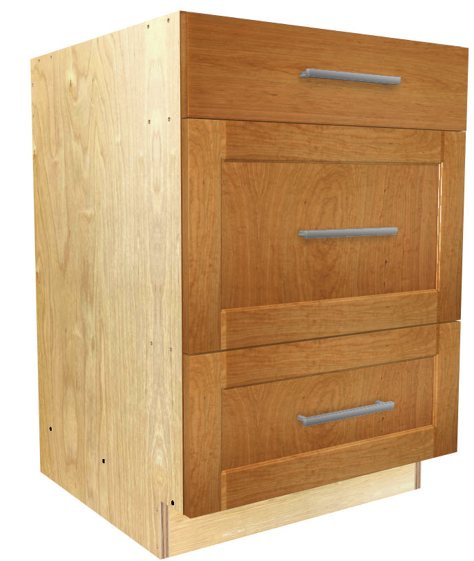

        April 13, 2026 at 11:56 am
        To request a change to the drawer box depth for that cabinet, simply include the request in the notes field at checkout, on the screen where you enter your credit card. Keep the notes brief, as too many details can complicate order processing.
        Personally, I think that configuration may look unbalanced. We can attempt it as a custom request if you would like, but I recommend sticking with the standard options to keep things simple.
        • Mystic.Musketeer
          April 14, 2026 at 9:55 pm
          Ok. Thank you for the rendering. We will go with the recommendation of going with the standard staggered option.
            April 15, 2026 at 2:02 pm
            Sounds good. Thanks!

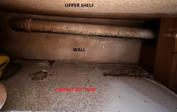

    March 5, 2026 at 6:06 am
    I have attached a couple pictures. One of them (pipe.jpg) shows its current state. I don’t think it is the plastic ABS kind. It goes through the wall into the stucco and is accessible on the exterior when the sink gets clogged. I have also attached a rendering of my design in this section that shows the B45|B3DR|SINK2D.

    March 5, 2026 at 12:23 pm
    Yeah, it looks like black ABS plastic that was probably covered in primer and paint during the previous renovation. Since it exits straight through the back wall, there really isn’t any practical way to drop the elevation without creating a section of pipe where water would sit permanently, which obviously isn’t ideal.
    In this case, I would simply route it inside the cabinet by notching the cabinet backs and sliding the cabinets over the pipe. That’s a pretty common solution and not a big deal. You can also request that the lower drawer be reduced to around 15″ (or whatever dimension is needed) to accommodate the pipe. That part is easy to adjust.
