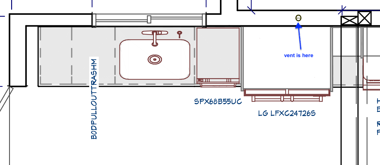

    I am having trouble running the vent through the wall behind my kitchen sink due to a window behind sink and only a 2×4 wall.
    We are thinking of swapping the position of the dishwasher and pullout trash cabinet to make room for the vent (design attached)
    question:
    is it ok to notch the B1DPULLOUTTRASHSINGLEM cabinet to run a 2” vent through the back of this cabinet?
    any suggestions of how you see people handle something like this?
    thank you
    Scott

    This is for the sink drain vent (2”). Want to make sure we get the underground plumbing correct (which we are doing now) before I order the cabinets. I need to get the vent from the sink drain to the existing vertical vent.
    I realized I included the wrong product code on my original post.

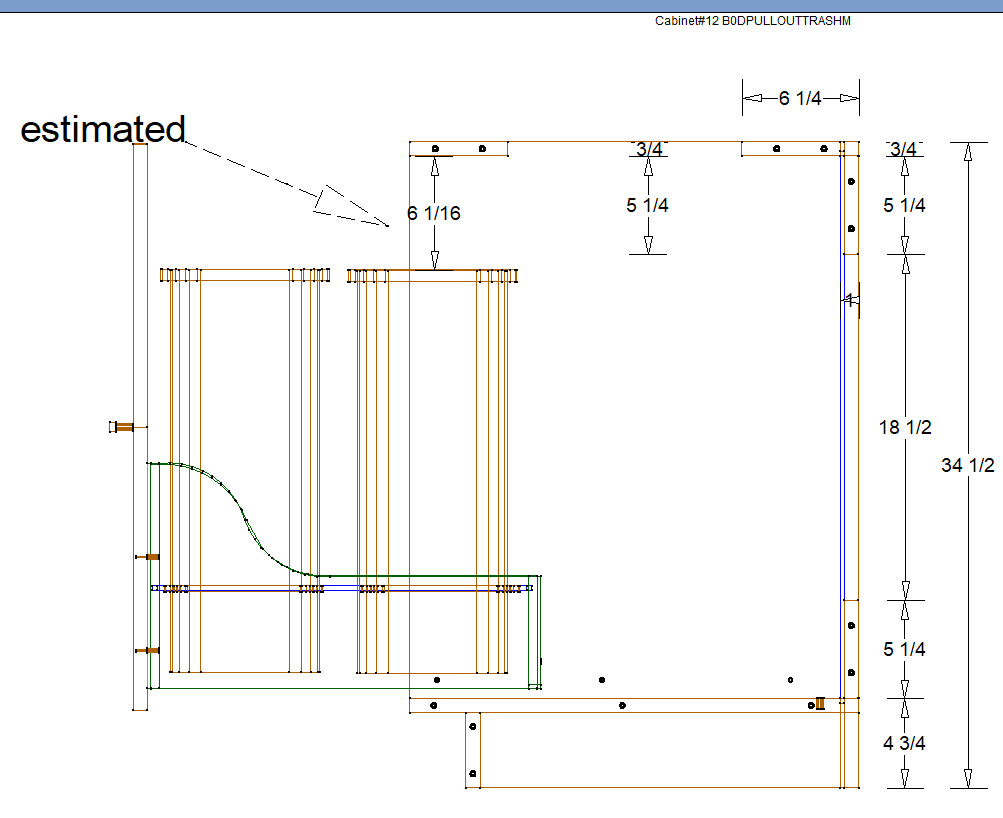

    For a 18” wide 34.5” tall B0DPULLOUTTRASHM, can you confirm my understanding of the cabinet construction?
    side panels are 3/4” each
    back panel is 3/4”? How tall is the top panel in back of the cabinet I see in the cabinet (attached)? What is the elevation of it?
    So, for a cabinet depth of 24”, I will have:
    24” – 3/4” (rear piece) = 23.25” clear depth inside cabinet (without trash cans inside)
    Height of 34.5”, I will have:
    34.5” – 4” (toe kick) – 3/4’ (top) = 29.75” clear height inside cabinet
    Width of 18”, I will have:
    16.5” clear width inside cabinet (without trash cans inside)
    January 24, 2026 at 11:40 am
    Correct. Please see the attached drawings showing each dimension. Let me know if you need anything else.
