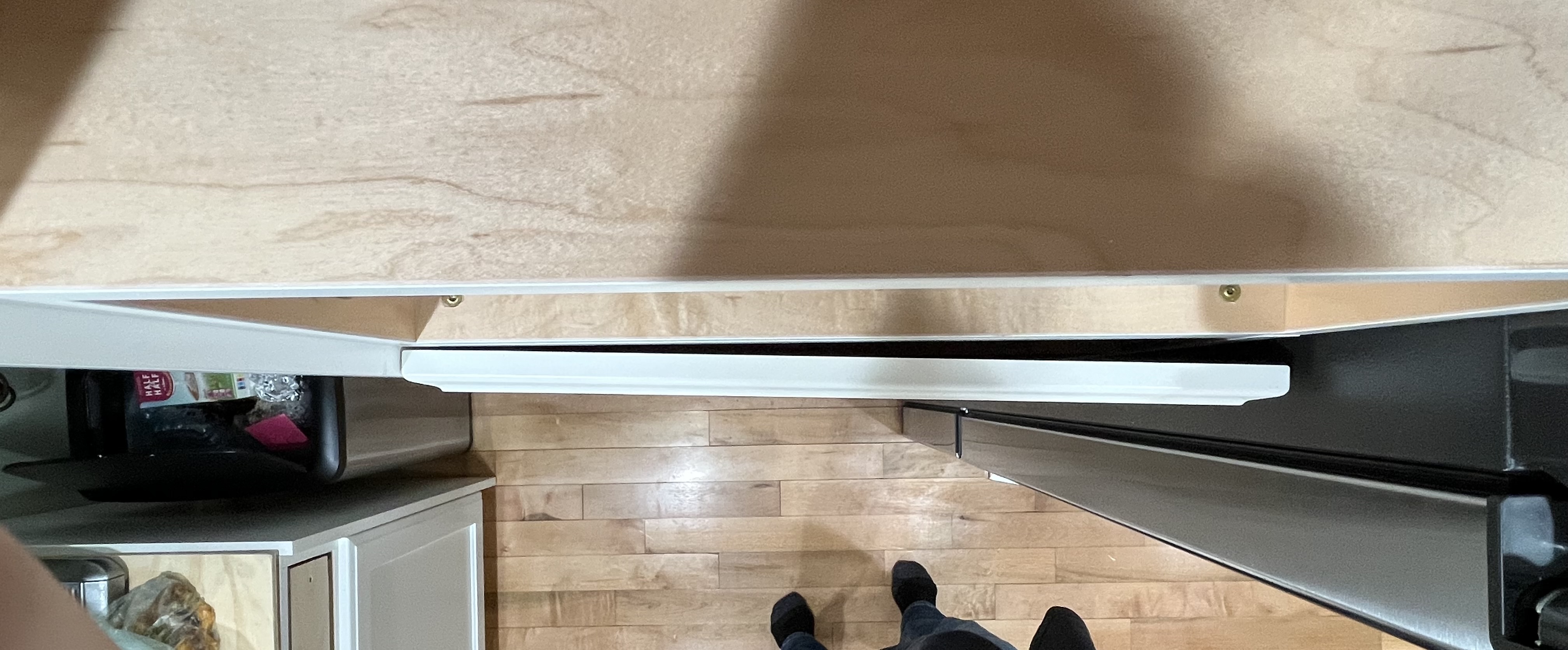

  • in reply to: Door adjustment #4225
    Kenschretlen
      sorry I can’t edit out the last picture being included again, not sure why, so ignore the last picture, if you want another one w/the edge fully out I can post it as well
      in reply to: Door adjustment #4223
      Kenschretlen
        Hey Chad,
        I’ve tested it w/all kinds of combinations, both the top and middle all the way out and the bottom all the way in, middle mid way, top full out and bottom full in and still out. I removed the door and set on my granite island countertop and it indeed is warped. I’ve sent an email to begin the warranty process. Thanks again for your help.
        Ken
        • This reply was modified 3 months, 1 week ago by Kenschretlen.

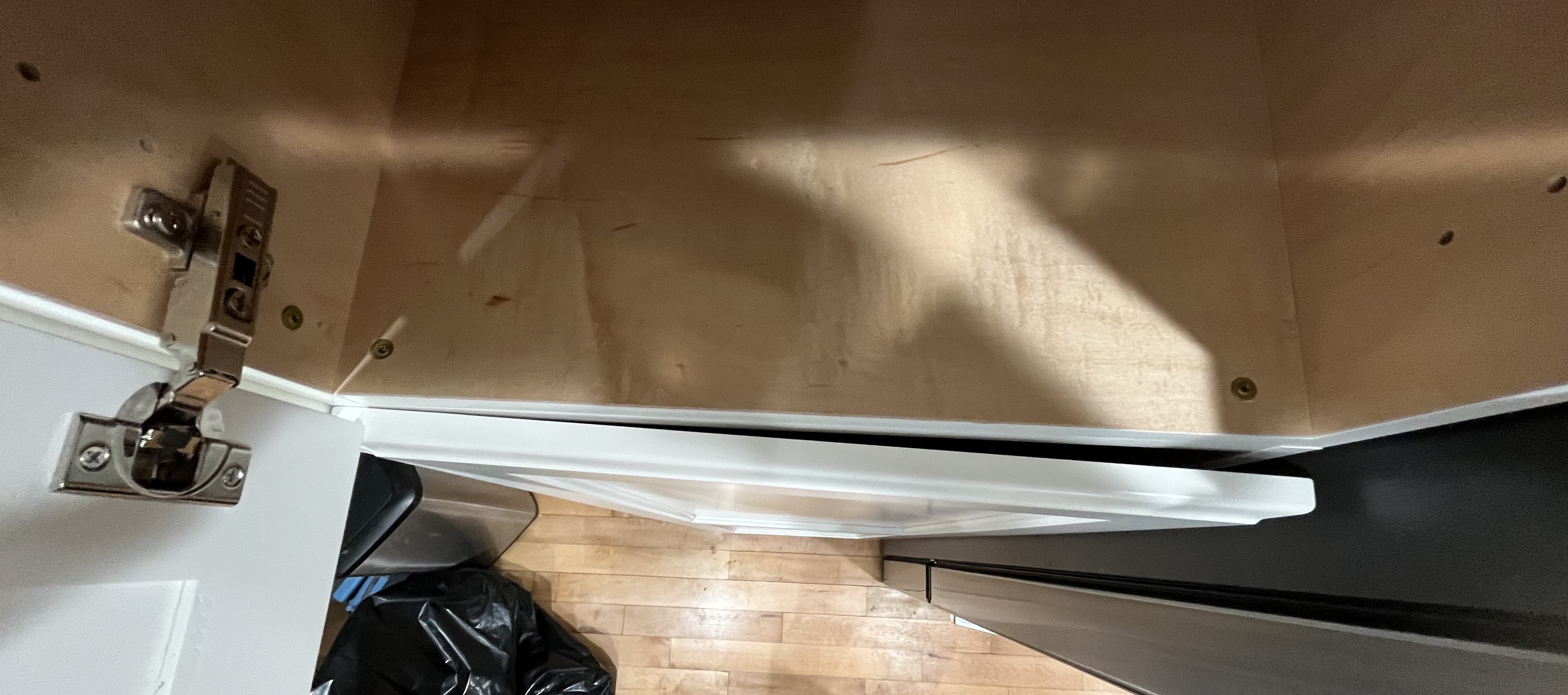

        in reply to: Door adjustment #4154
        Kenschretlen
          Hey Chad,
          Yes I’ve tried quite a bit of changes to the door hinge adjustments, but can’t get it to set properly. Here’s with the hinge end adjusted now as suggested.
          Ken

            in reply to: Door adjustment #4107
            Kenschretlen
              Perfect, that fixed it!
              I have the same issue on my pantry door and unfortunately it already had the bottom hinge fully out away from the cabinet and the top one fully in- I had been playing with all kinds of combinations and finally decided to stop and move on. Now, after fixing the one, this one is not coming together. See attachment.
              Thanks,
              Ken
