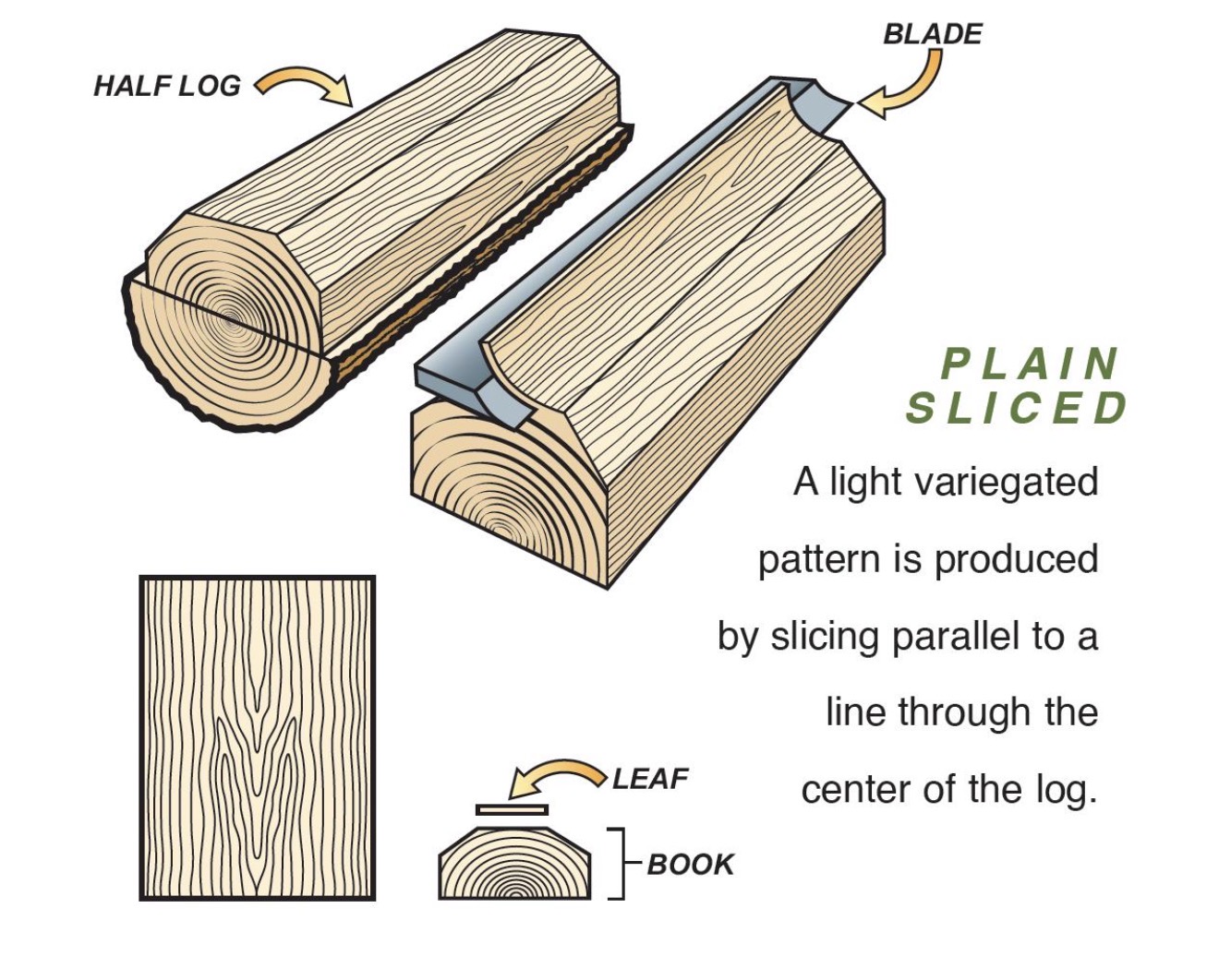

                  Slab maple doors (plywood slab doors with banded edges) are made from maple veneer over a plywood core. The panels come pre sanded from the mill, are cut to size, edge banded, and then hand sanded with an orbital sander using 220 grit to clean up the seams after banding.
                  There should not be saw marks, as sheet veneers are not cut using a saw blade. If a stain is revealing swirl or “saw like” marks, it may be highlighting the orbital sanding pattern from production. In that case, a light once over with a higher grit sandpaper before staining may help reduce the visibility. Lighter stains tend to be much more temperamental and will expose surface inconsistencies far more than darker stains. Combine this with the fact that each real wood veneer species accepting stain differently and you can see why pros charge a ton for hand staining.
