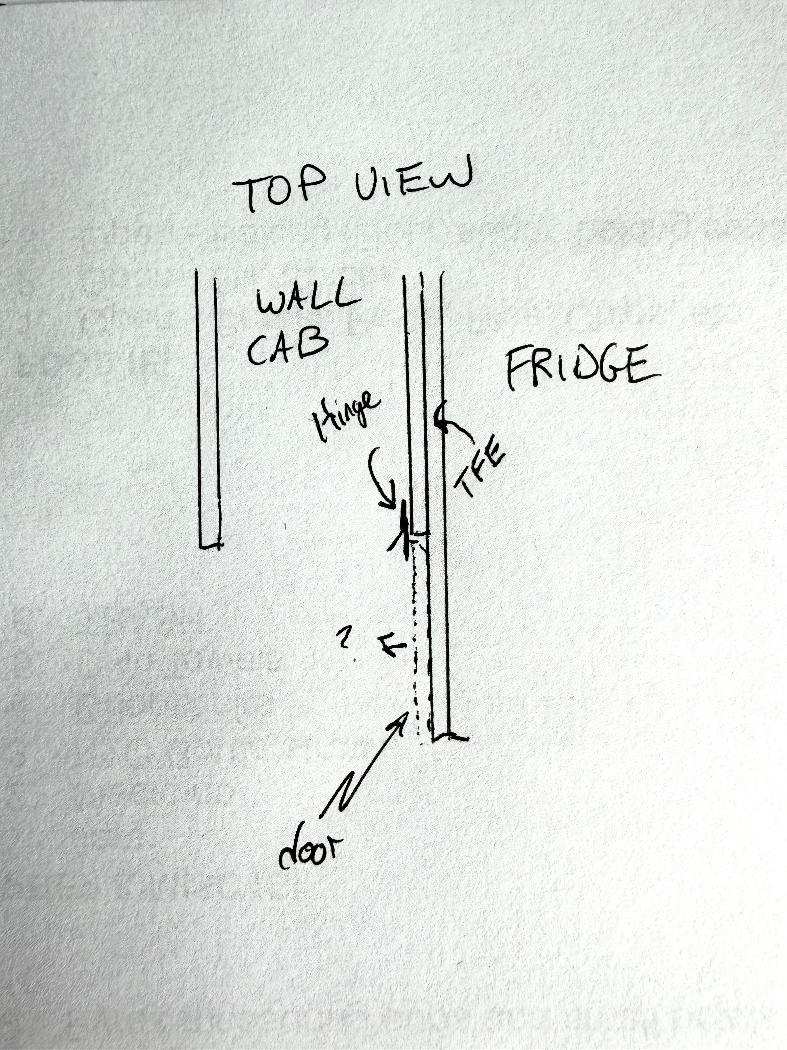

              djd
                At risk of beating the horse here, still wondering about the cabinet door adjacent to the fridge TFE.
                See pic for our current situation. It drives me a bit nuts tbh as the door cannot open 90 degrees because it starts to rub with the fridge AND the handle protrudes 1″ from door.
                For the Blumotion hinges, how does the door sit when open 90degrees?
                e.g., is it in plane with the side of the cabinet, or sitting inward somewhat?
                It seems to get the full 90 degree open I would need some spacer, or possibly to move to a single door so it opens beyond the TFE (although this would be a pretty large door ~21″ wide).

                  Sure, we have this in our showroom. See this video for a bit of a walkthrough:

                    Ok I’m convinced! Appreciate the demo Chad and cabinets look great.
