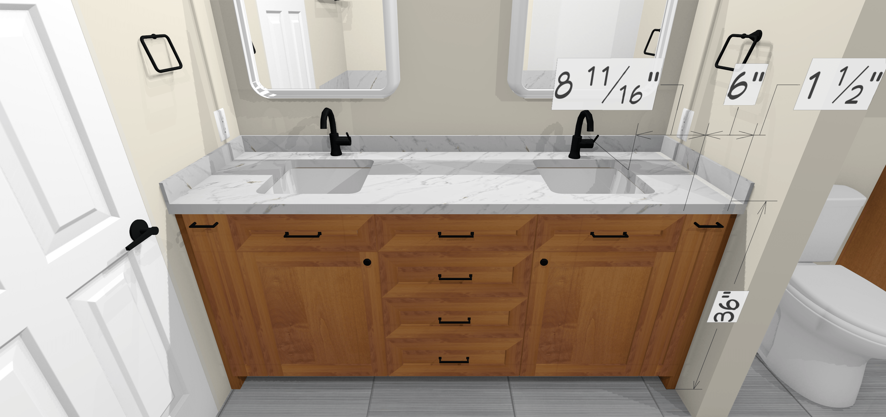

        I’m going to use Rev-A-Shelf 3” and 6″ Filler base cabinet pullouts in several areas of my bathrooms (22″ depth base cabinets) because I don’t want to waste the excess tiny space leftover. These just need a 3” and 6″ gap between cabinets, and I’m going with these since your slim Haefler pullouts only work for 24″ base cabinets.
        How do I order full size (30.5″) 3” and 6″ pieces that would look like doors? Because the 3″ is so small, would it just be a slab door or do you do something to it so it’s a bit more decorative? (I’ll be ordering the Shaker Inset for my other doors/cabinets). And can the 6″ have a Shaker Inset or is that also a slab?
        Also, these pullouts would be between a sink base and a filler/wall, so I’m guessing that I’ll need to either add scrap wood to the wall in order to attach the wall side of these pullouts (if I use a normal BDEEPFILLER 2″ wall filler piece) or put in one of your BFETHICK ends to attach the pullout to on the wall side. Going with the BFETHICK is kinda expensive for not needing to see it, but it would make it so that when you pull out the pullout, there would be a “side” on the wall side. I only have about 1.5″ of space for the filler, so if I go with a BDEEPFILLER, I’ll have to rip it down to 1.5″ regardless.
        If I go the way with a BFETHICK (assuming that fits), is there any way to order a BFETHICK with maple veneer on one side but keep the other sides with the color of the cabinets (in my case, clearcoat cherry)? I was thinking that since the sink base side would be maple veneer (and all other interior cabinets are maple), it might be nice to have the wall side of the pullout also be maple. But no biggie if you can’t do this or it costs way more! Thanks!
