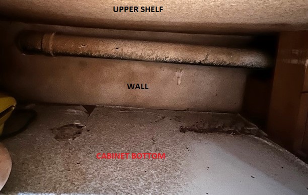

        We have kitchen drain as shown in the attached image. We are thinking of having a base corner 45 and potentially a 3 drawer cabinet – [ B45 | B3DR | SINK ]. With regards to this the questions I have are:
        1) The cabinets would be 24 in deep. The drain pipe is about 2.5 in from the wall. Would the drawers have a depth of 21 in, such that they are not obstructed by the drain pipe?
        2) As the drain pipe run across cabinets [ 45 base corner | 3 drawer base | 2 door sink ], we would need to create cut-outs in the side walls of the cabinets. Would this be ok? (Please see attached picture for the cross section view of one of the walls.)
        3) What is the size of the opening of a 34.5 in x 34 in x 24 in x 24 in 45 deg. base cabinet?

            The drain is 6 inches above the bottom of current base cabinet. That would make it about 10 in above the floor. So, doesn’t look it could be concealed. The outer edge of this pipe is 3 in from the wall. So, I am concerned that will obstruct a drawer. Having a B3DR here would be great but considering the measurements is it possible to reduce the depth of the lower most drawer?

                        I have attached a couple pictures. One of them (pipe.jpg) shows its current state. I don’t think it is the plastic ABS kind. It goes through the wall into the stucco and is accessible on the exterior when the sink gets clogged. I have also attached a rendering of my design in this section that shows the B45|B3DR|SINK2D.

                          Yeah, it looks like black ABS plastic that was probably covered in primer and paint during the previous renovation. Since it exits straight through the back wall, there really isn’t any practical way to drop the elevation without creating a section of pipe where water would sit permanently, which obviously isn’t ideal.
                          In this case, I would simply route it inside the cabinet by notching the cabinet backs and sliding the cabinets over the pipe. That’s a pretty common solution and not a big deal. You can also request that the lower drawer be reduced to around 15″ (or whatever dimension is needed) to accommodate the pipe. That part is easy to adjust.
