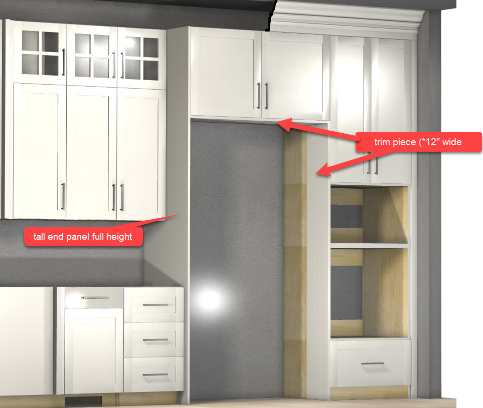

    Sure. It sounds like you are deciding between trimming out the refrigerator opening or leaving the opening bare and setting the refrigerator flush, with no filler or separation piece between the refrigerator and the tall pantry stack. Either approach will work well.
    I actually did this in my own kitchen and chose to install a square trim piece between the refrigerator and the tall pantry stack to create a bit of visual separation between the appliances. In hindsight, this was not strictly necessary. High-end refrigerators such as Sub-Zero and Liebherr are designed so their doors can open fully with zero protrusion, even when placed tight to adjacent cabinetry. While I would not recommend placing one directly against a wall, this highlights how well these doors are engineered. This is very different from most standard counter-depth refrigerators, which often require a completely different cabinet configuration to prevent door interference with adjacent cabinets.
    You can go either route. You may add trim to the top and right side as shown in the photo below, or omit the trim on those sides and run the refrigerator tight to the tall cabinet on the left. In the worst case, you may see a small amount of exposed cabinet-case maple when the door is open, but this can easily be painted or touched up to match. If you have plenty of space and do not mind sacrificing an additional 3/4 inch, trimming out the opening as I did is a clean, finished option.
    As for the trim pieces themselves, they do not need to be as wide as the ones shown in my photo. I used 12 inch material simply because I had it on hand. I would recommend ordering a couple of Tall Slim Fillers, which are inexpensive and deep enough to adequately shield the exposed cabinet sides.
