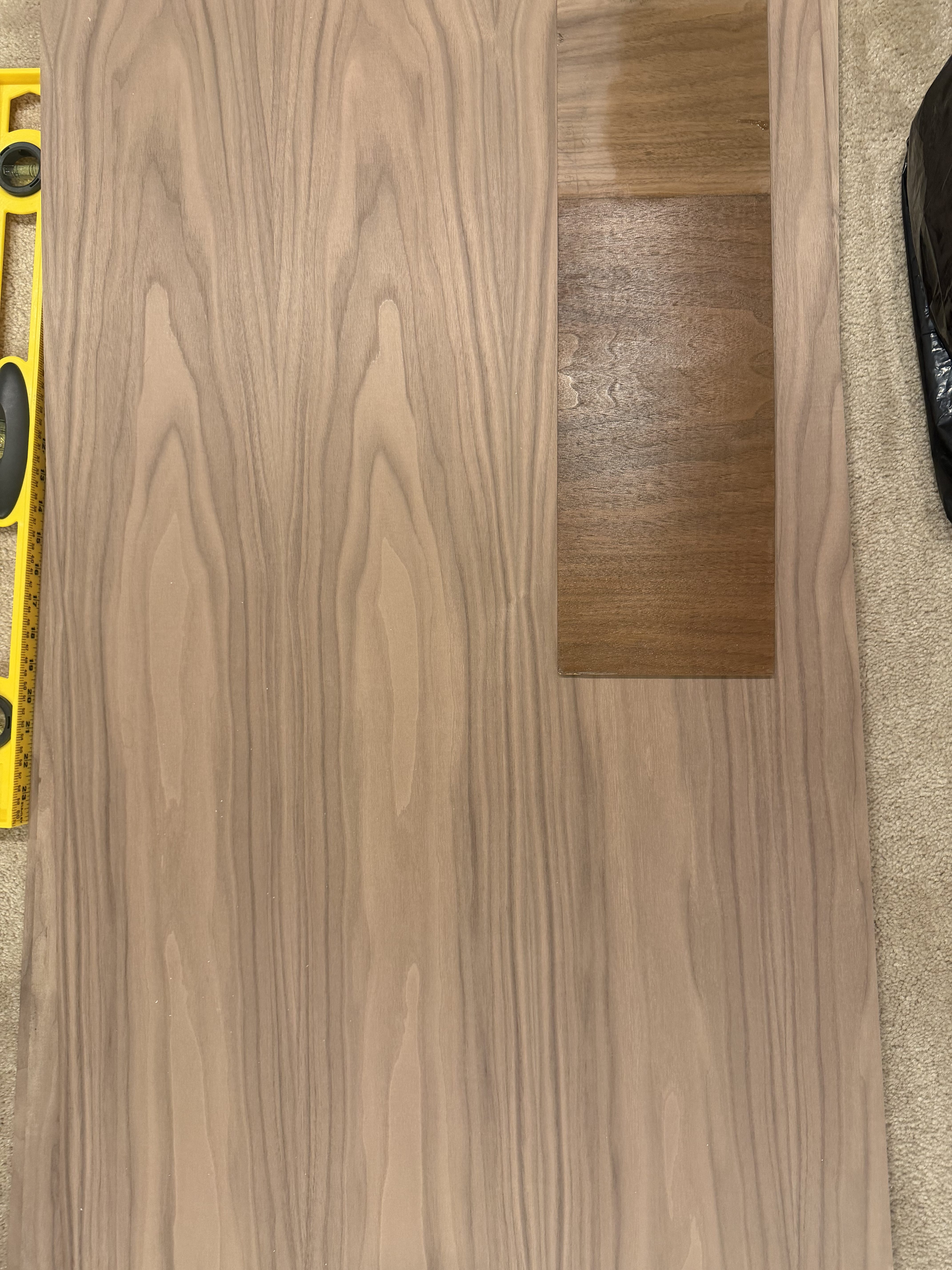

    I purchased walnut slab cabinets in Tamarack from City Cabinets (which are gorgeous btw), and I’m trying to match this tamarack stain for a custom front face on a cabinet I’m building. Anyways, I bought the tamarack stain from you guys as well, but I cannot get it to match at all. It’s far too warm/light compared to the doors of the cabinets I bought. I’ve tried several methods and used the recommended poly as well as other types/colors as well.
    Is there a particular kind of walnut that’s used for the veneer? Any help or tips would be greatly appreciated, as this custom front face will be next to these cabinet doors from you guys and I really need them to match.

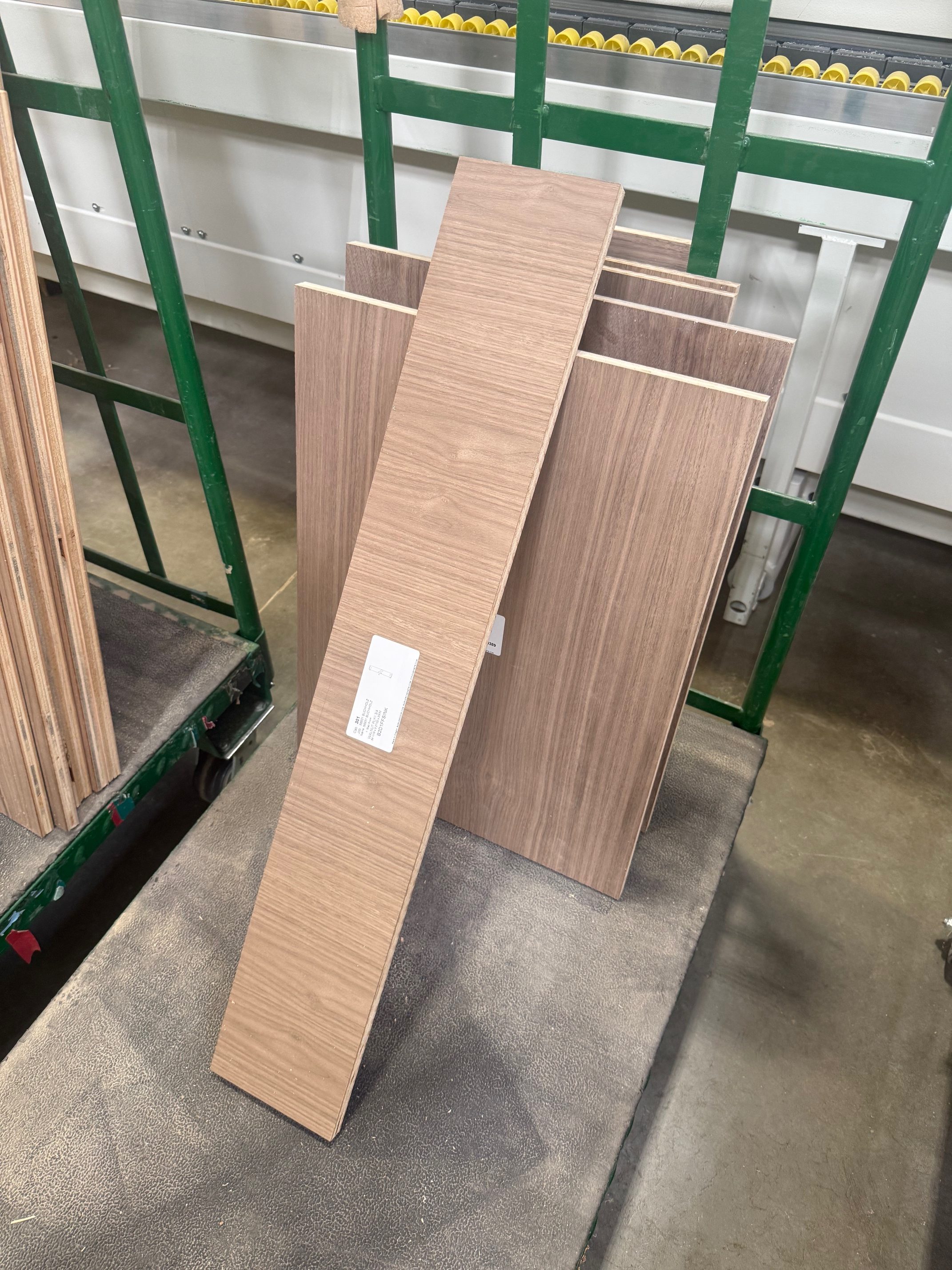

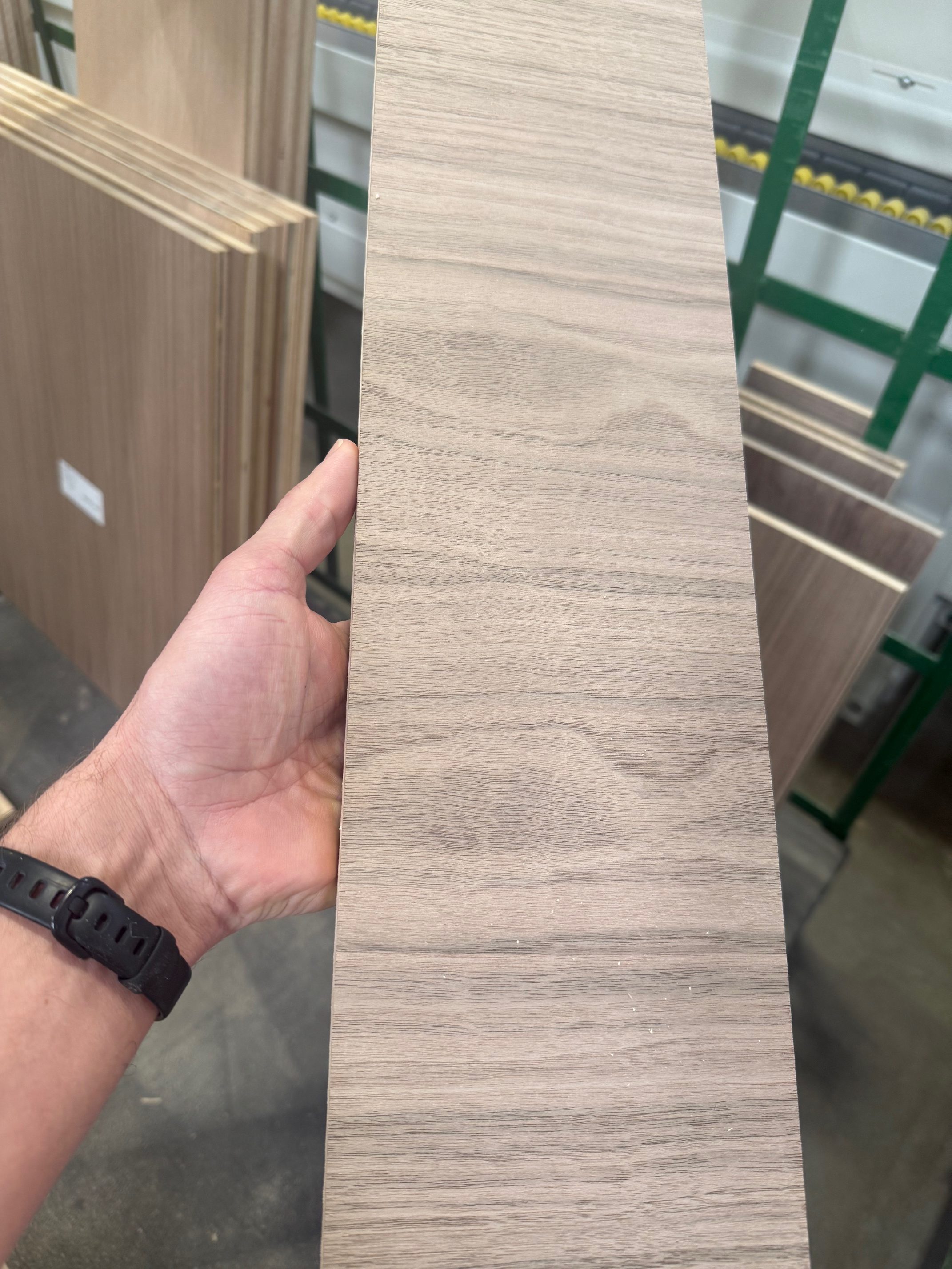

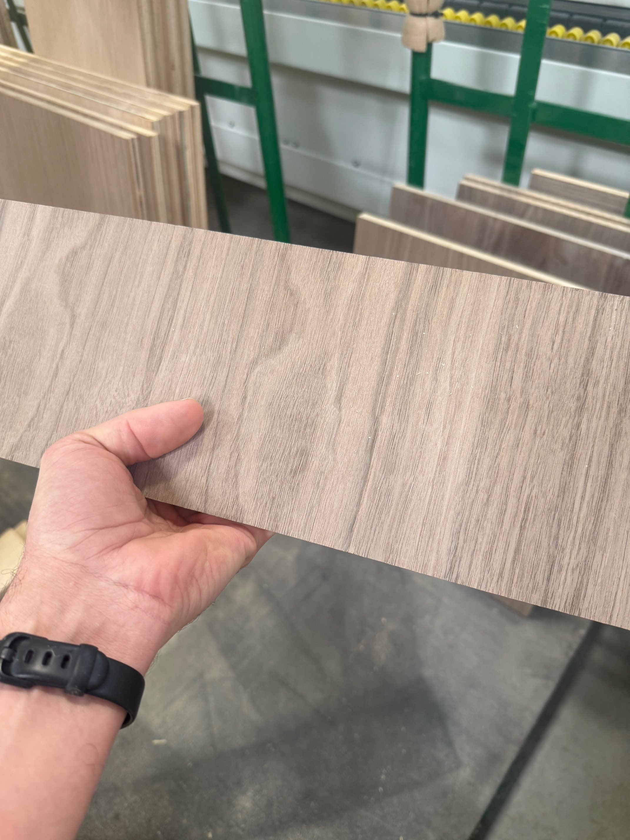

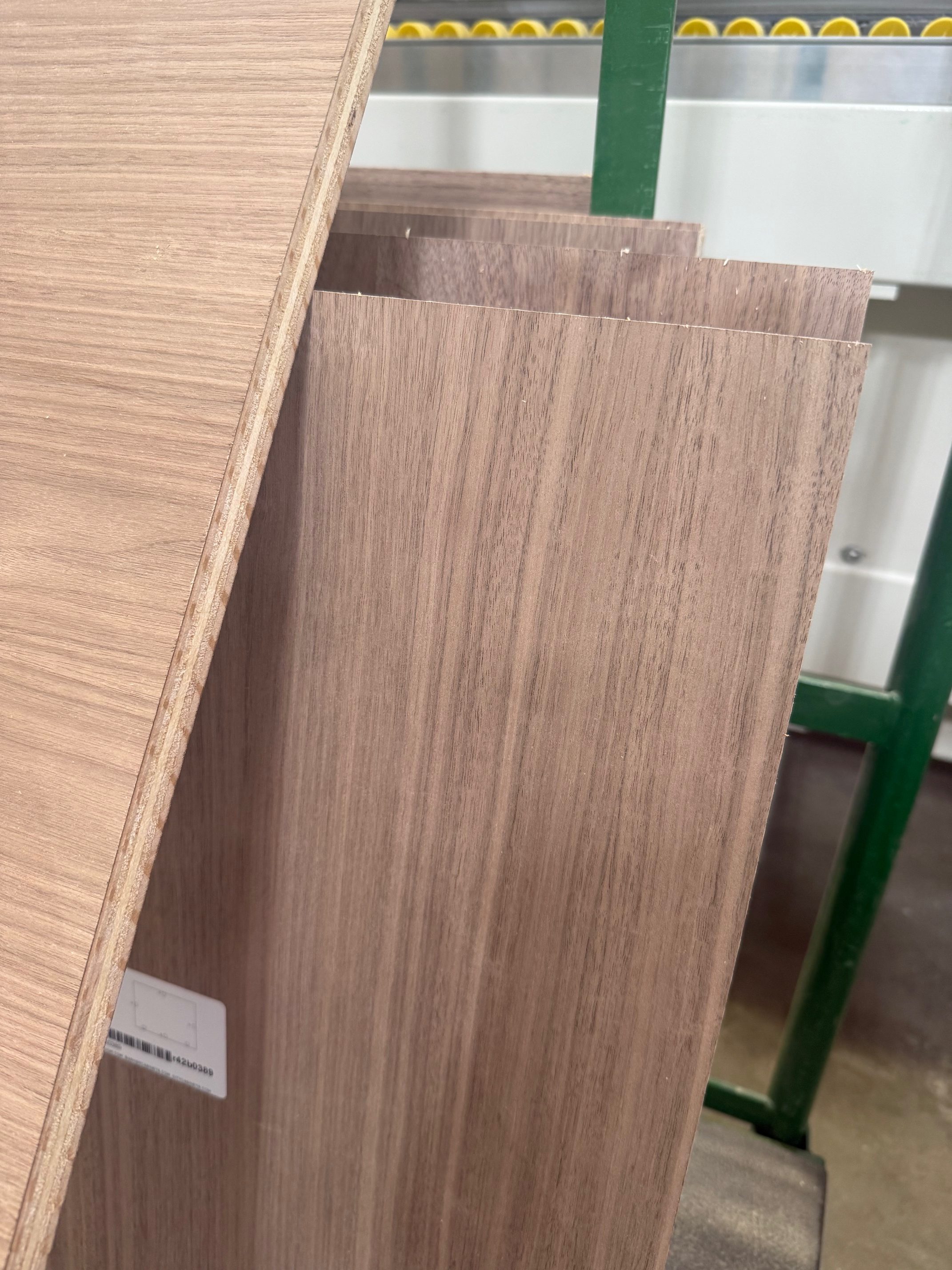

    The bottom portion of your wood sample does appear a bit light. Most black walnut is typically fairly dark, and while the grain of your sample does look consistent with walnut, the color of the veneer itself is on the lighter side.
    Normally, I would say that most walnut veneer is sourced from the same mills in the eastern United States. However, I have been seeing more products advertised from a wider range of sources lately, so I can’t say with certainty why this particular piece is so light. It appears to resemble walnut sapwood, which is typically taken from the outer portion of the walnut tree.
    I will post a few photos of the walnut plywood we currently have on the shop floor from another project so you can gauge how dark the walnut veneers we are using actually are. I will also include a reference image showing walnut sapwood alongside the range of typical walnut color variation. That said, veneered walnut is almost always sourced from the heartwood, which is the most desirable part of the tree, so I’m not sure why veneer would be taken from sapwood—this is very uncommon.
    Please note we sell plywood doors and drawer fronts by themselves over on barkerdoor.com. They are not expensive.

    Thanks for the photos! Yes, that is raw walnut you pointed to. Here’s some more pictures of the raw walnut I have. I laid down my testing piece on top for some reference. The stain color looks great until I put it next to the existing cabinets.

      It was in fact the undertone of the walnut wood I purchased. I did buy a sprayer and while that did make it darker, it was still too warm/red. I ended up doing one layer of a green wash (used a diluted green stain) to counteract the red tones, then used the tamarack stain. I also noticed the satin polycrilic was too shiny to match, and the matte one was much closer, but ended up doing a 90% matte to 10% satin ratio of the polycrylics to get it to match spot on. Now that I got my test pieces to match, I can proceed. Thanks for all your help!

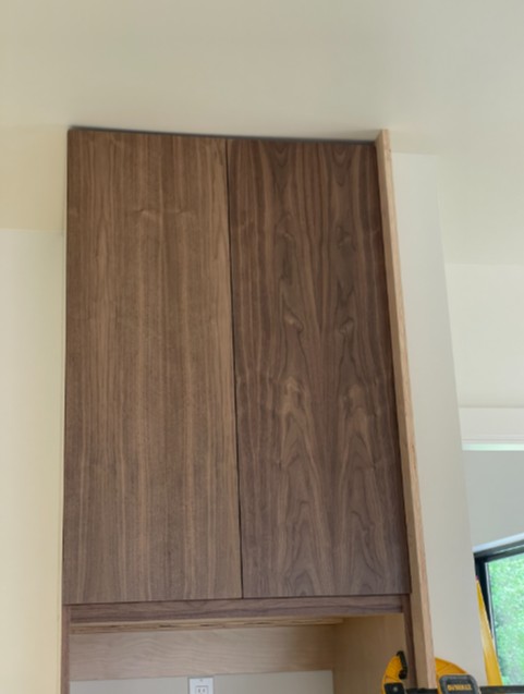

    Hey Chad, I’m in a similar situation trying to match some slab plywood walnut cabinets with the clearcoat finish.
    Do you guys use Quarter Sawn Walnut Veneered Plywood? Or Panel Sawn/Plain Sliced?
    (Pictured below are the city cabinet panels installed)
    May 26, 2026 at 2:04 pm
    We use plain sliced walnut veneers for the walnut plywood.
