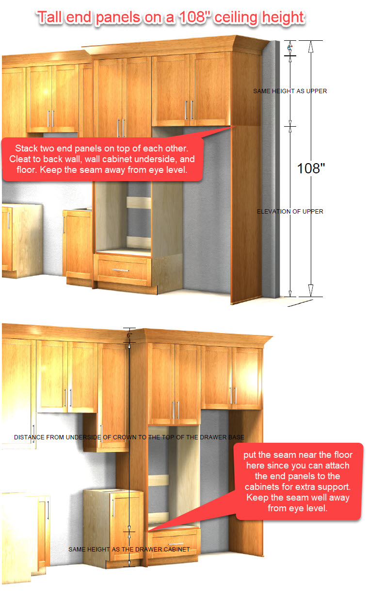

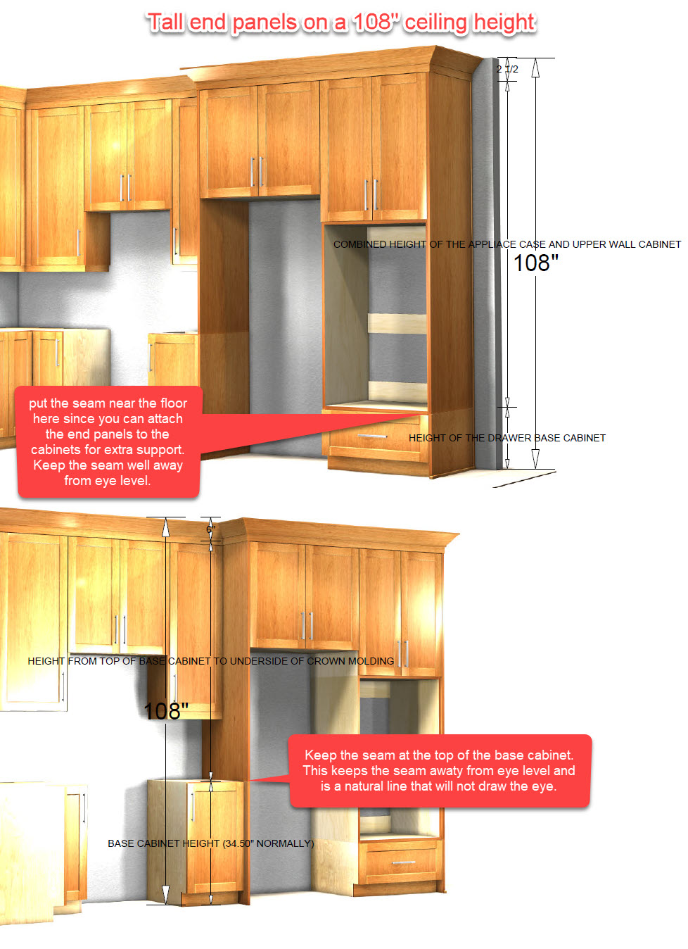

    We have a ceiling height that is 108″ and were wondering what we could do on the sides of the built in subzero refrigerator. We are using the crown molding trim that is 6″ tall. So we would most likely need a panel that was 102″. How would we use what you have available?

    We cannot offer a single full-height finished end panel, as the sheet sizes are limited to a maximum height of 96″. To achieve a total end panel height of 102″, you would need to stack two panels on top of each other. Below are two examples of refrigerator openings and tall cabinet combinations.

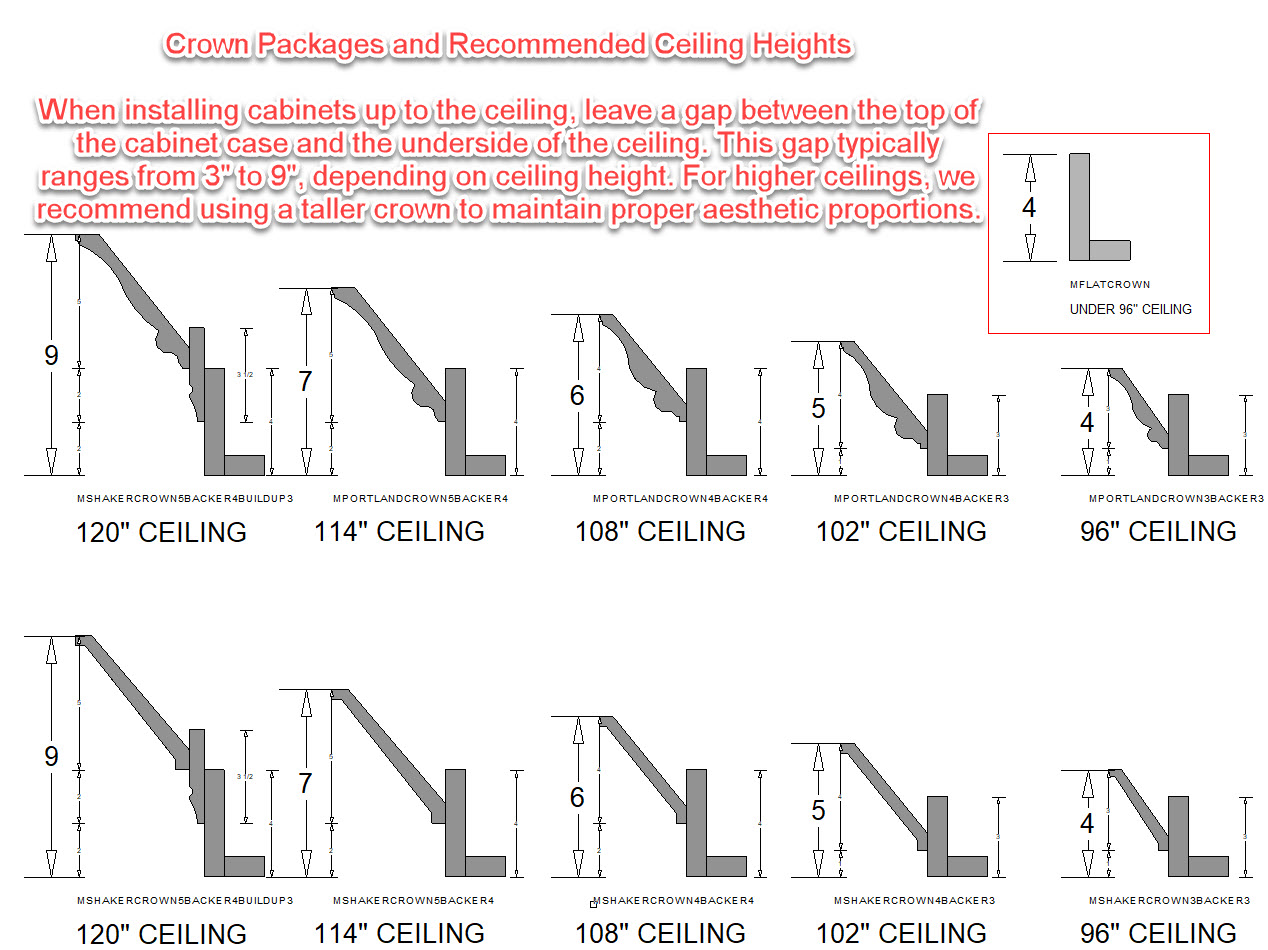

    February 28, 2025 at 9:39 am
    The easiest solution is to increase the height of your crown package by 1″ to 2″ if you’re extending the cabinets to the ceiling. For a 96″ ceiling, use a 5″ to 6″ crown package instead of a 4″.
    Crown packages in 4″, 5″, and 6″ heights consist of two separate pieces that can be adjusted up or down on the backer. You can order a tall end panel and corresponding cabinet stack at 90.75″ and use a 5″ crown package with minimal floating adjustment (about 1/4″) during installation. This allows for flexibility when attaching the crown molding to the backer.
  • Mike Huhn
    February 28, 2025 at 10:40 am
    Thanks – Are you suggesting shorter cabinet stack to go with the taller crown?
    February 28, 2025 at 11:03 am
    Yes, tall cabinet stack total height and the overall height of the tall end panel should be the same height. Just increase your crown molding package height as needed.
