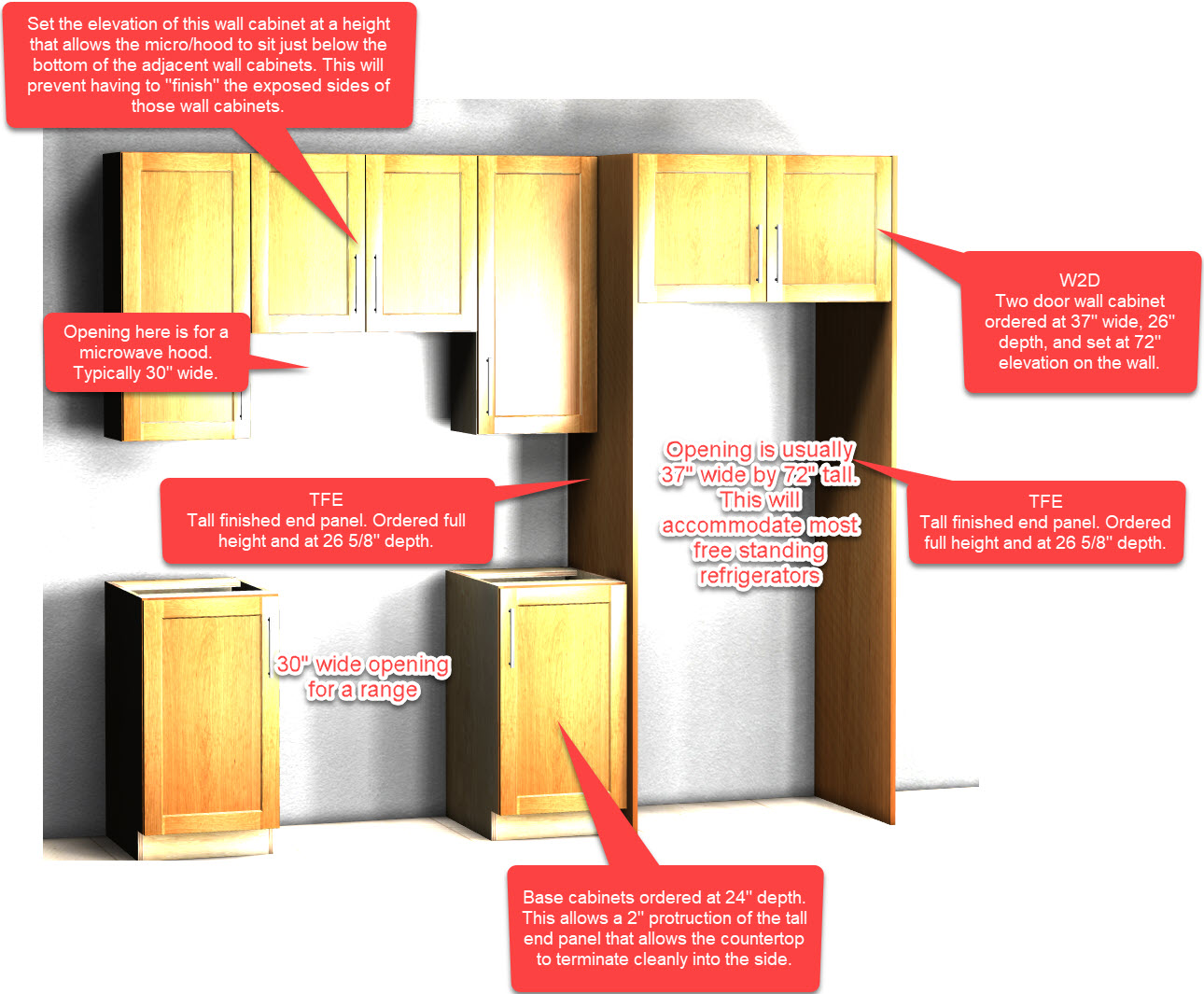

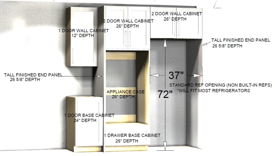

    Hi – My fridge requires a 36in width cut out opening. It appears the max opening width for the free standing fridge case is 34 1/2. Is there an option for the free standing fridge appliance case to have an opening width of 36?

    There is no need to use a separate cabinet to house a refrigerator. That refrigerator case is for very specific models that require venting and a dedicated opening. If you have a regular 36″ tall refrigerator, simply create a 37″ wide by 72″ tall opening like this:

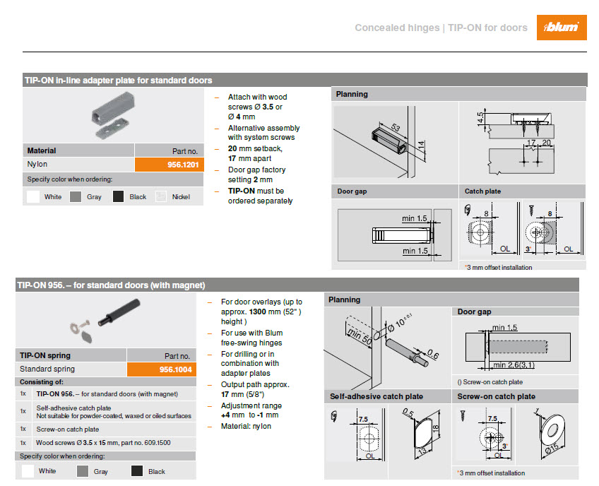

    ​Design Query: Is it feasible to manufacture this as a “hidden door” cabinet using a push-to-release magnetic latch, so the face appears as a seamless 7″ filler piece but functions as a broom/ladder closet? If not, please advise on the best filler-strip configuration to match.

    1. Sure, you can use push-to-open hardware to make the cabinet doors above your refrigerator into a hidden door area. You can buy this type of hardware from various vendors, and there are a few different installation options.
    I prefer the surface-mount piston style, so you are not stuck trying to drill deep holes into the face of your cabinet case. I took a quick look through the current brochure and grabbed a screenshot that I will attach.
