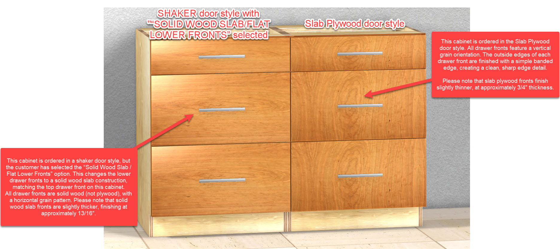

    For an all drawer base, If I select the standard inset shaker panel, then select the “SOLID WOOD SLAB/FLAT LOWER FRONTS” option, would this basically create a complete flat slab front look?

      tlondgren, I have this same exact question! So happy you’re getting it clarified. I want (if possible) solid wood, horizontal grain fronts on all my drawers.
    April 14, 2026 at 12:35 pm
    Yes, this will keep the solid wood slab top drawer front and make all lower drawer fronts match it exactly in solid wood slab construction with a horizontal grain pattern. The top drawer front is horizontal grain, and selecting the “Solid Wood Slab / Flat Lower Fronts” option ensures all lower fronts match with the same horizontal grain.
    When this option is selected, all drawer fronts on this cabinet are built in solid wood and match the thickness of our real wood frame doors (such as Shaker, Windsor, etc.), finishing at approximately 13/16″.
    Now, comparing this to the slab plywood door style: if this cabinet were ordered with slab plywood instead, it would have a noticeably different look. Slab plywood fronts use a vertical grain orientation and finish at approximately 3/4″ thickness, as that reflects the thickness of the plywood.
