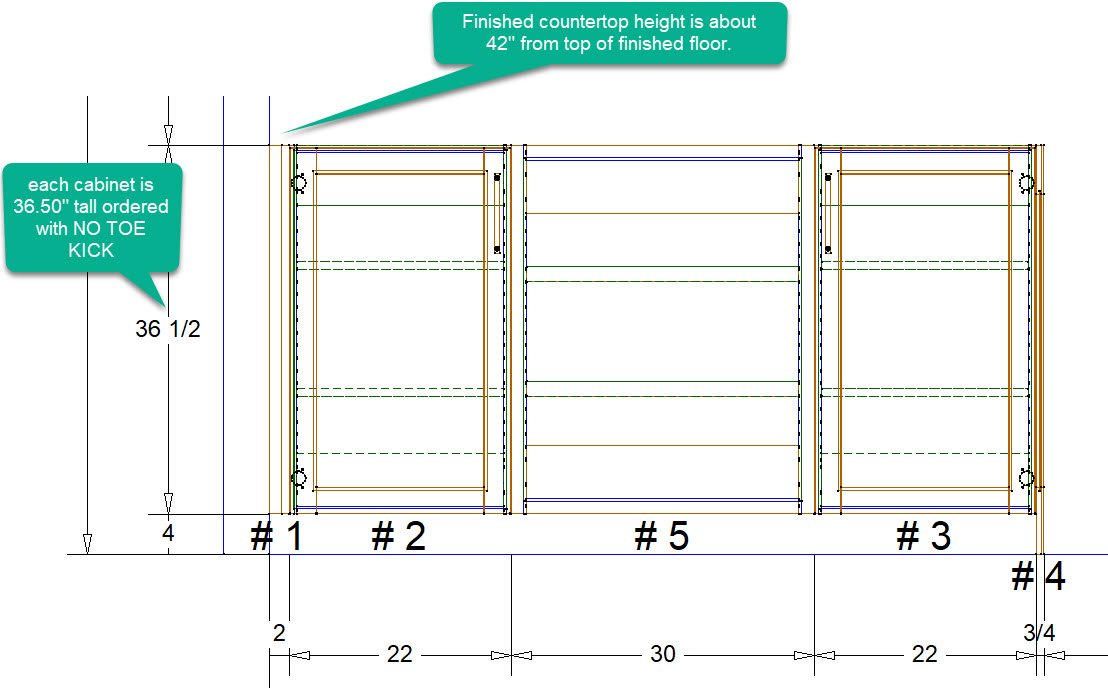

    October 24, 2025 at 11:00 am
    Sure, see her for how I would design this.
    October 24, 2025 at 11:04 am
    Note that this layout is based on a 42″ finished countertop height. The photo you provided appears to show a working height of about 42″, which is taller than the standard 36″ countertop height used in most kitchen applications.
    If you prefer the standard 36″ height, you’ll need to adjust the cabinet height accordingly. However, this setup looks more like a prep area, and the extra height is likely beneficial and more comfortable, in my opinion.

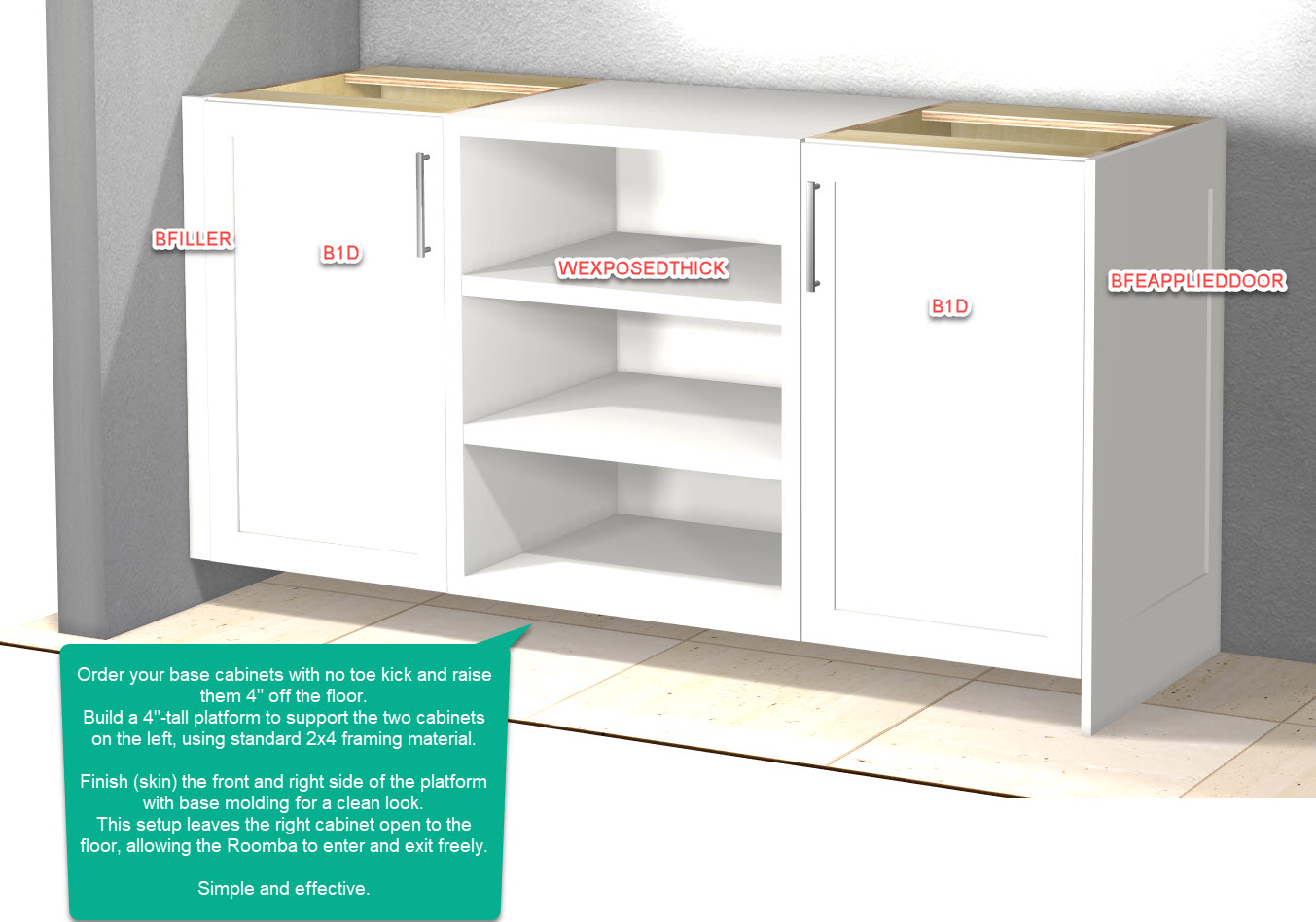

    Here’s a face view showing the cabinet heights for reference.
    October 24, 2025 at 11:06 am
    Also measure that ROOMBA to ensure it is less than 4″ tall while in operation. The toe kick height of 4″ might need to be pushed up higher to accommodate.
