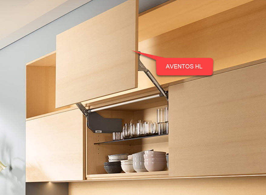

    Custom lift hardware (Blum Aventos style)
    You can order a standard one-door cabinet and request that the door not be drilled for hinges (add this in the order notes at checkout). You can then install your own lift hardware, such as a Blum Aventos HL system, which lifts the door up and out of the way. This works as an alternative to a pocket or retractable door. It does require selecting the correct power factor based on the door weight, but it can be installed after the cabinets arrive and are installed.
    https://www.blum.com/us/en/products/liftsystems/aventos-hl/programme/
