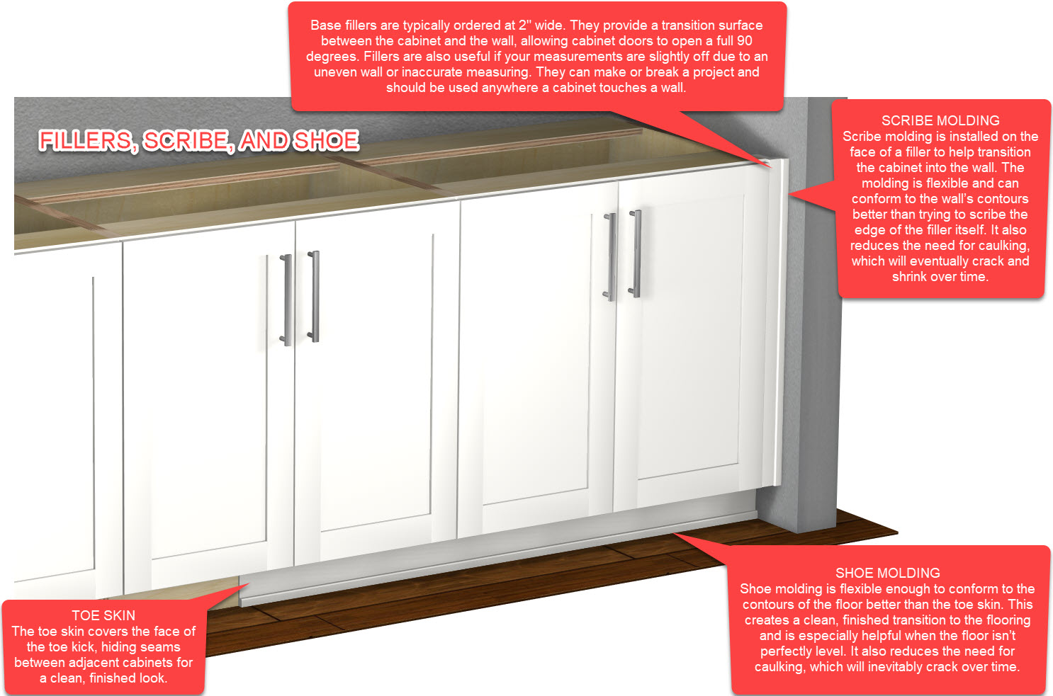

    Hi, I am about to submit my order for a peninsula that I’ve put together, but I am waffling on how to handle the back of it. IE: Should I order the slab bar back to be the same height as the cabinets (35 inches) and run it to the ground, or should I order it to be 31 inches and then use a toe skin to finish it. What do you typically recommend?
    I have an old home with floors that aren’t level, so my thought is that using the toe skin would have more give during the install…but would love to hear your thoughts!

    You can do it either way as there’s no set standard.
    There are benefits to running a separate toe kick underneath the bar back. This allows you to add a toe skin and a strip of shoe molding, which helps the molding conform better to uneven flooring. It also tends to be more durable since the toe skin can absorb wear and tear from sweeping or, heaven forbid, mopping close to the island. Over a 20–30 year lifespan, this setup may result in less visible damage compared to a full-height bar back that touches the floor directly.
    On the other hand, I believe a full-height bar back gives the island a more custom, polished look, especially when finished with base molding around the back. You can run it full height, add base molding, and then a strip of shoe molding to give it some added dimension. That’s how I did mine. The corners are a bit of a toe-stubbing hazard, but I prefer the look overall and I’m happy with the appearance.
