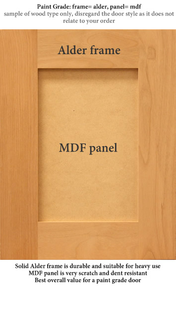

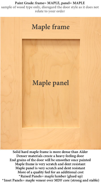

    I wanted to order cabinets with the Dover White door pre-finishing and was wondering if there are any tradeoffs between choosing the “Paint Grade” wood option or one of the species such as Maple or Red Oak. On some of the cabinets, such as the w45, I even notice that you can choose between two kinds of paint grade woods.
    For example, I know that Alder is a softer wood, so if I wanted a more durable door, should I choose Maple as the wood type instead of Paint Grade Alder and then select Dover White for the pre-finishing?

    To answer your question—yes, you can certainly mix and match different wood types with paint or stain. The PAINT GRADE wood types listed are simply our recommended options for painting. My preferred paint-grade wood is PAINT GRADE MAPLE. It’s the heaviest and hardest option, with an even and smooth grain pattern. It resists dents and dings, making it a great choice if you have kids who might be rough on the kitchen.
    Alder is the most affordable material we offer. It’s good for painting but softer than maple, meaning it will dent and ding more easily. Otherwise, once painted, I can’t tell the difference between alder and maple unless I pick them up—maple is noticeably heavier.

    Between the painted Alder and Maple options, does either do a better job with eventual movement in the door front joints (causing lines in the finish)?
    February 15, 2025 at 2:28 pm
    Both would be about the same in regards to slight joint cracking over time. The alder might be a bit more flexible, so it could hold up slightly better.
