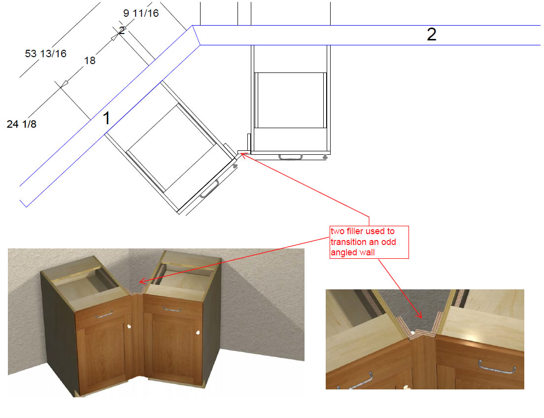

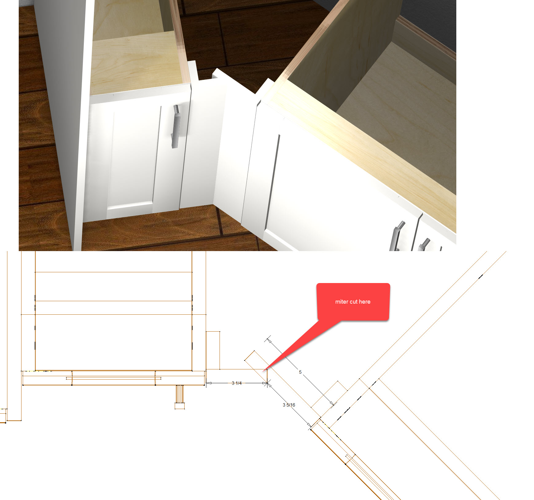

    For the fillers in a 135-degree corner, see the attached image. The typical approach is to use two fillers, for example one 2-inch wide and one 4-inch wide. The wider filler is attached to one cabinet, and the smaller 2-inch filler is miter-cut at 45 degrees so it terminates into the face of the wider filler.
    You can also order the fillers oversized and trim them on site to the final dimensions. This gives you some flexibility to dial in a tight, clean fit without gaps.

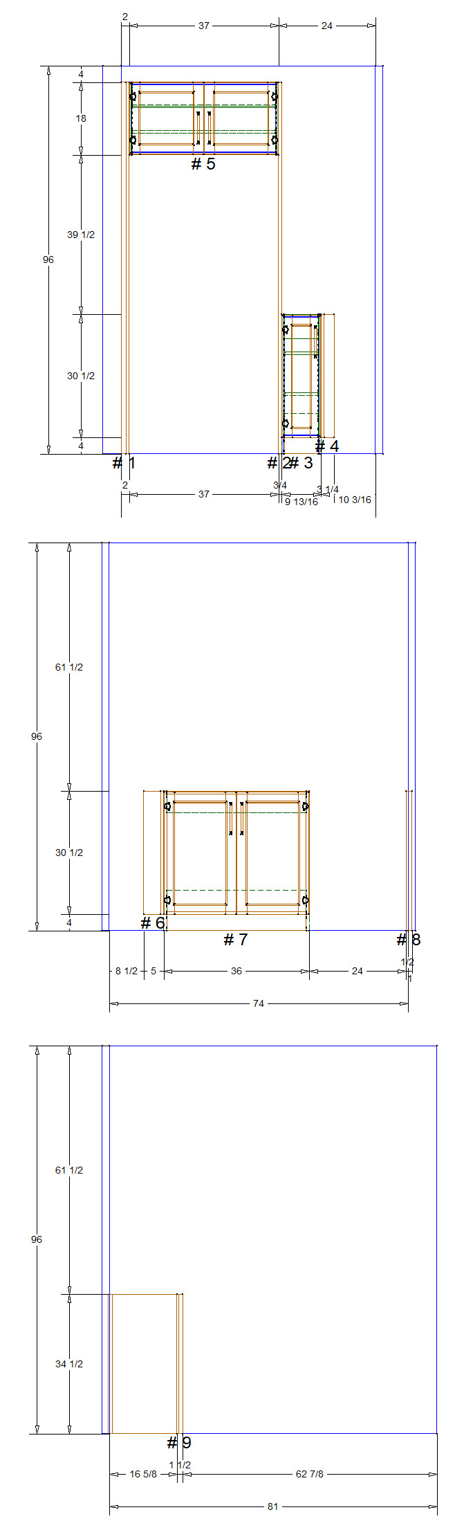

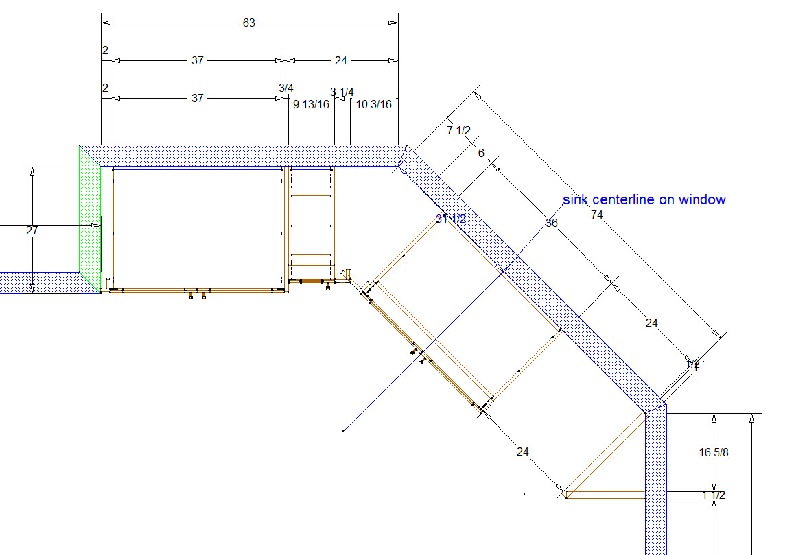

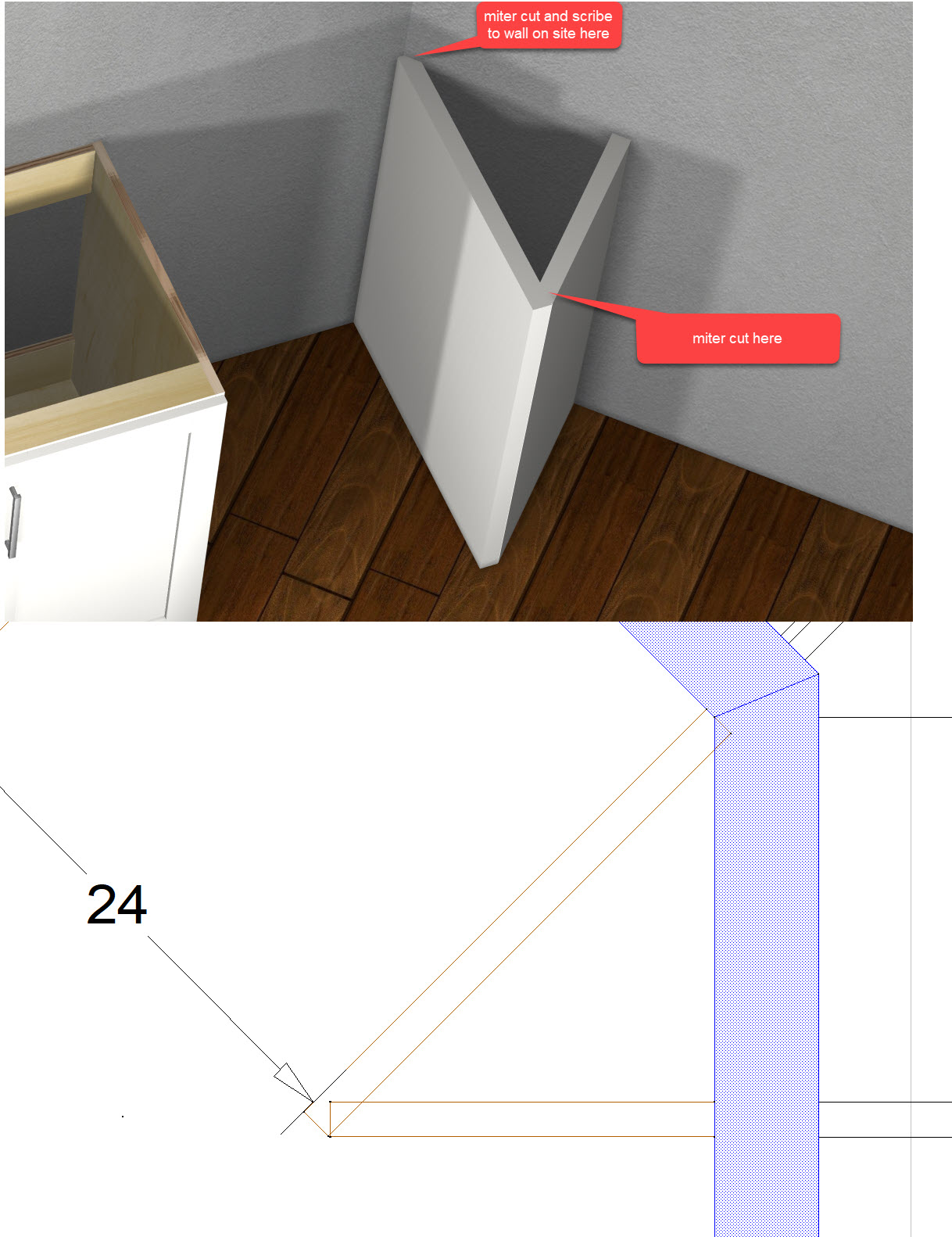

    Sure, see here for a quick sketch. This is how I would approach this tight angled area.
    Note that this is a tight space, and some miter cuts will be required to make this work. The thick finished end panels are ideal for the right side of the dishwasher. These panels can be cut and scribed together to create a clean, seamless transition while also providing proper countertop support on the right side of the dishwasher.
    Please note that the refrigerator opening is a standard 37″ wide × 72″ tall opening, with a filler running down the left wall. The tall cabinet at the refrigerator opening should be 26″ deep, while the base cabinets to the right are 24″ deep. This provides a clean termination point for the countertop to die into the side of the tall cabinet end panel.
    Keep it simple. See here:
