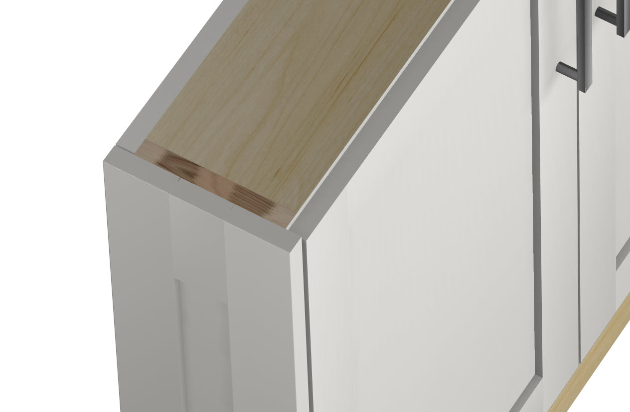

    I’ve put together a mock-up below showing the top view and how I would personally configure something like this.
    March 19, 2026 at 2:11 pm
    another close up:
