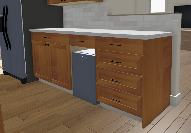

    i need my filler to be 4-1/2 inches instead of 3 to clear my stove door. it seems i cant pick that dimension when ordering or edit it in chief architect. are the holes already drilled for the other protruding filler? if not i guess i just put it where ever i want? and add the 1.5 inches to the blind dimension.
    also i built my kitchen in chief architect with the baker cabinets library but i want to order city cabinets. are both lines dimensionally the same to order city using the baker list i have? thanks.

    Sure. The holes are pre-drilled for the 3” filler, as shown.
    If you’d like the holes removed for the integrated filler, you can request that on City Cabinets using the dropdown option provided. For Barker Cabinets, this is not a selectable option on the website, but you can request hole deletion in the order notes during checkout.
    Please note that deleting the holes does not change the filler size. For example, if you plan to move the integrated face-frame filler 1” to the right, you’ll also need to pull the cabinet 1” away from the right wall. In other words, make sure your overall cabinet sizing calculations account for any filler relocation so the finished installation dimensions are correct.

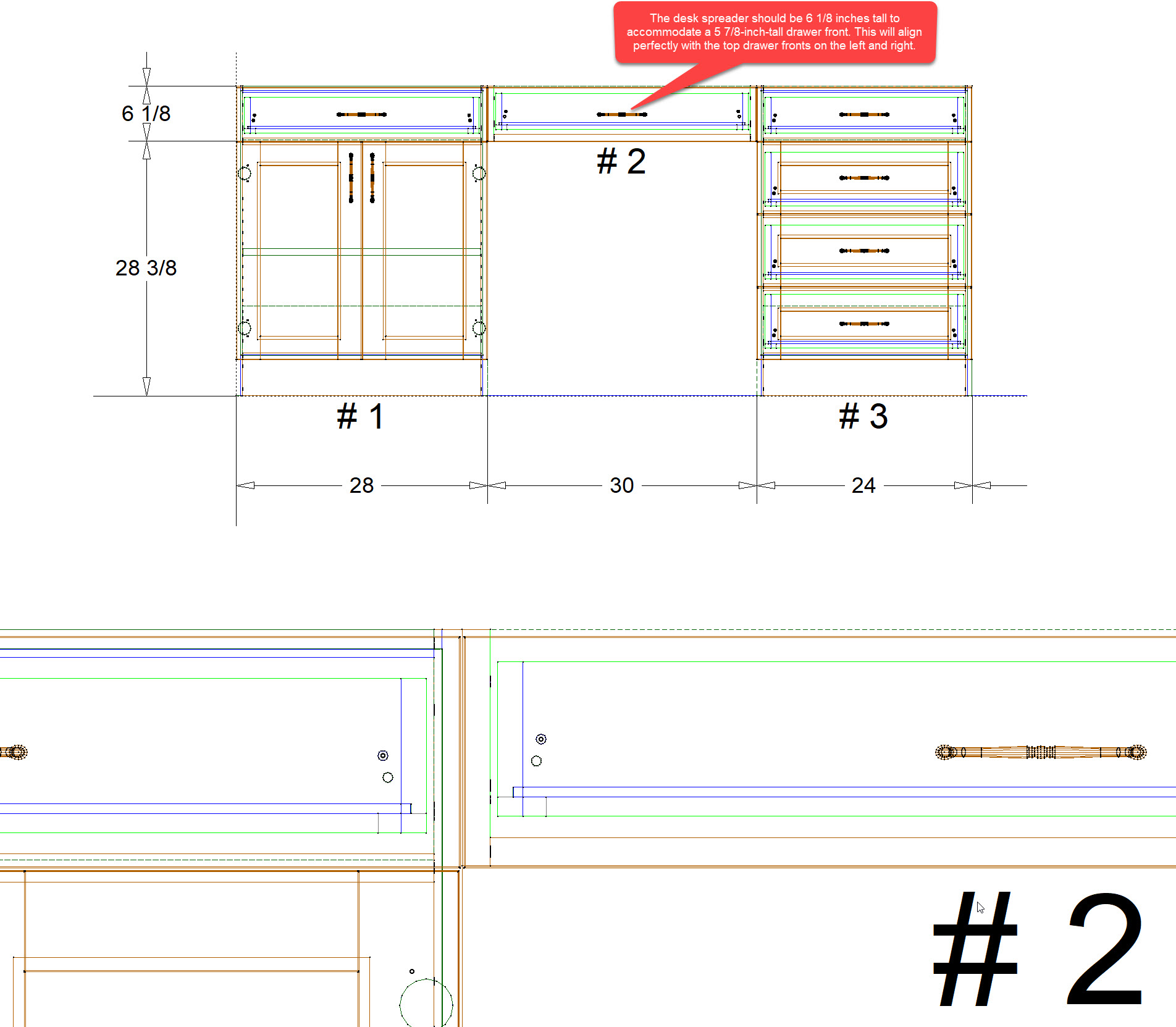

    for the middle 1 drawer pull out, what size do i order to make it match the height of top drawer on either side. thanks
    July 3, 2026 at 11:35 am
    Sure, please see here. The desk spreader cabinet should be exactly 6 1/8 inches tall to accommodate a 5 7/8-inch-tall drawer front, matching the drawer fronts on the surrounding cabinets.
    You will need to order the cabinet at 6 inches tall, then request in the order notes at checkout that the height be changed to 6 1/8 inches, since the website does not offer 1/8-inch increments.
