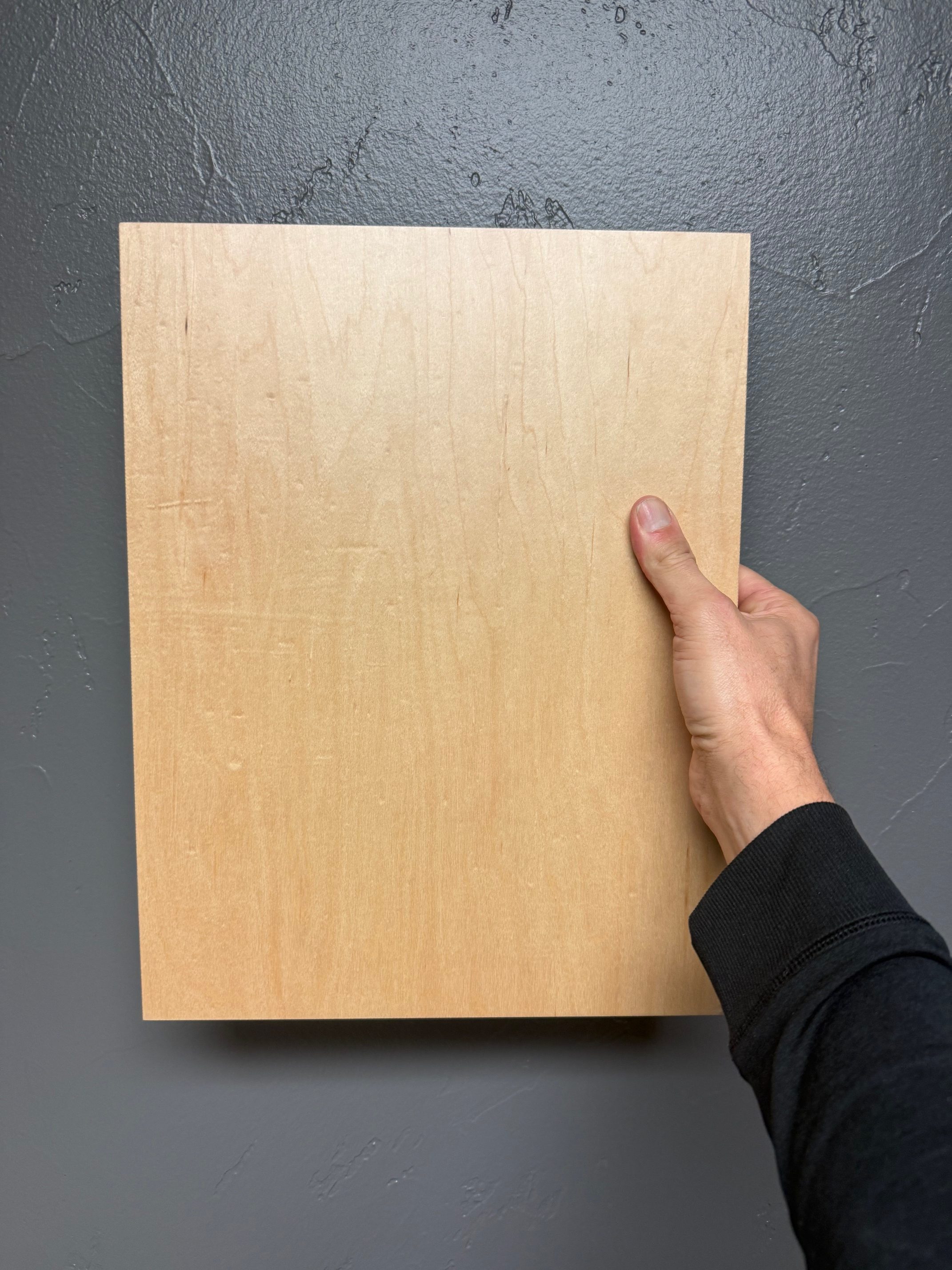

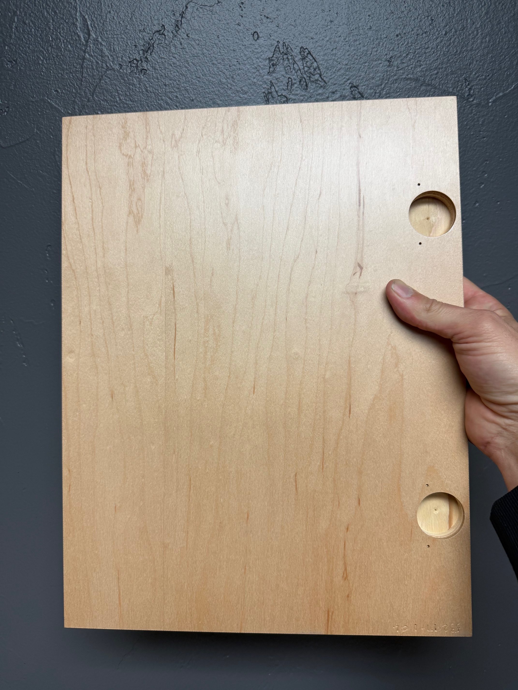

    November 18, 2025 at 4:47 pm
    Sure. A paint-grade slab plywood door is built using a 3/4″ plywood core with a maple veneer on the face, back, and all edges. You can order it as raw wood, where you’ll see the natural maple veneer, or you can order it primed or fully painted in any of our offered paint colors.
    There is no option to order a slab door without veneer. Removing the veneer would make the plywood unstable and prone to warping, and it’s also not a stocked or readily available material. The veneer on both the face and back is what keeps the core flat and stable, resulting in a clean, durable cabinet door that will last for decades.
    Here are a few photos showing what a slab plywood door made from paint-grade maple looks like. This particular maple door has a clearcoat, but it gives you an accurate idea of the veneer and construction used.
