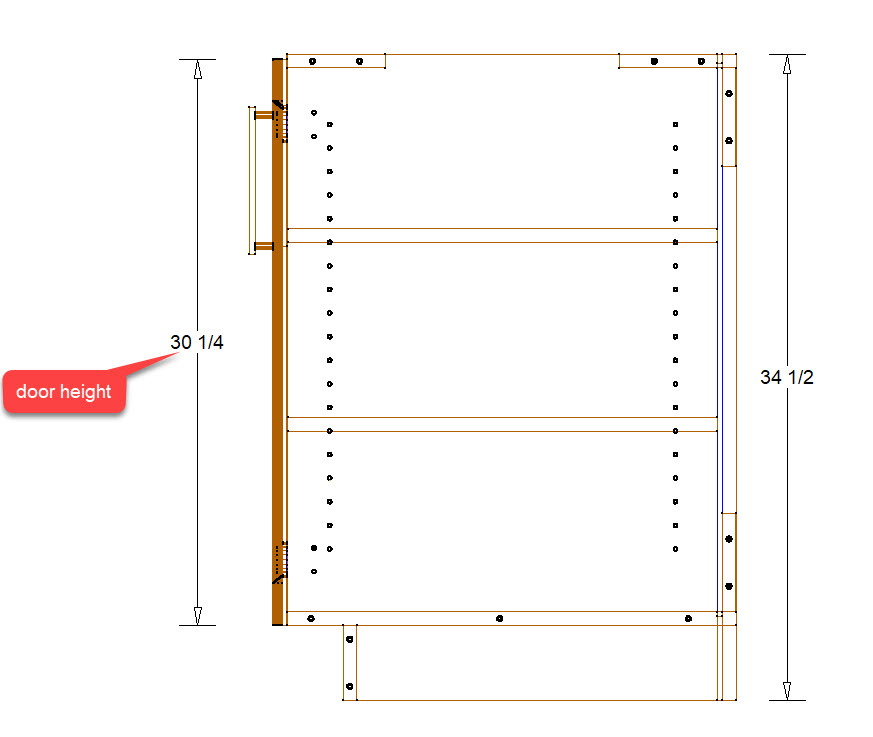

    OK, dumb question, but is the height of a full door for a standard 34.5″ base cabinet 30.25″? I saw a dimension on one of your other cabinets, but I thought I better confirm. Thanks.
    April 2, 2026 at 12:59 pm
    Correct, the door height would be as shown here:
