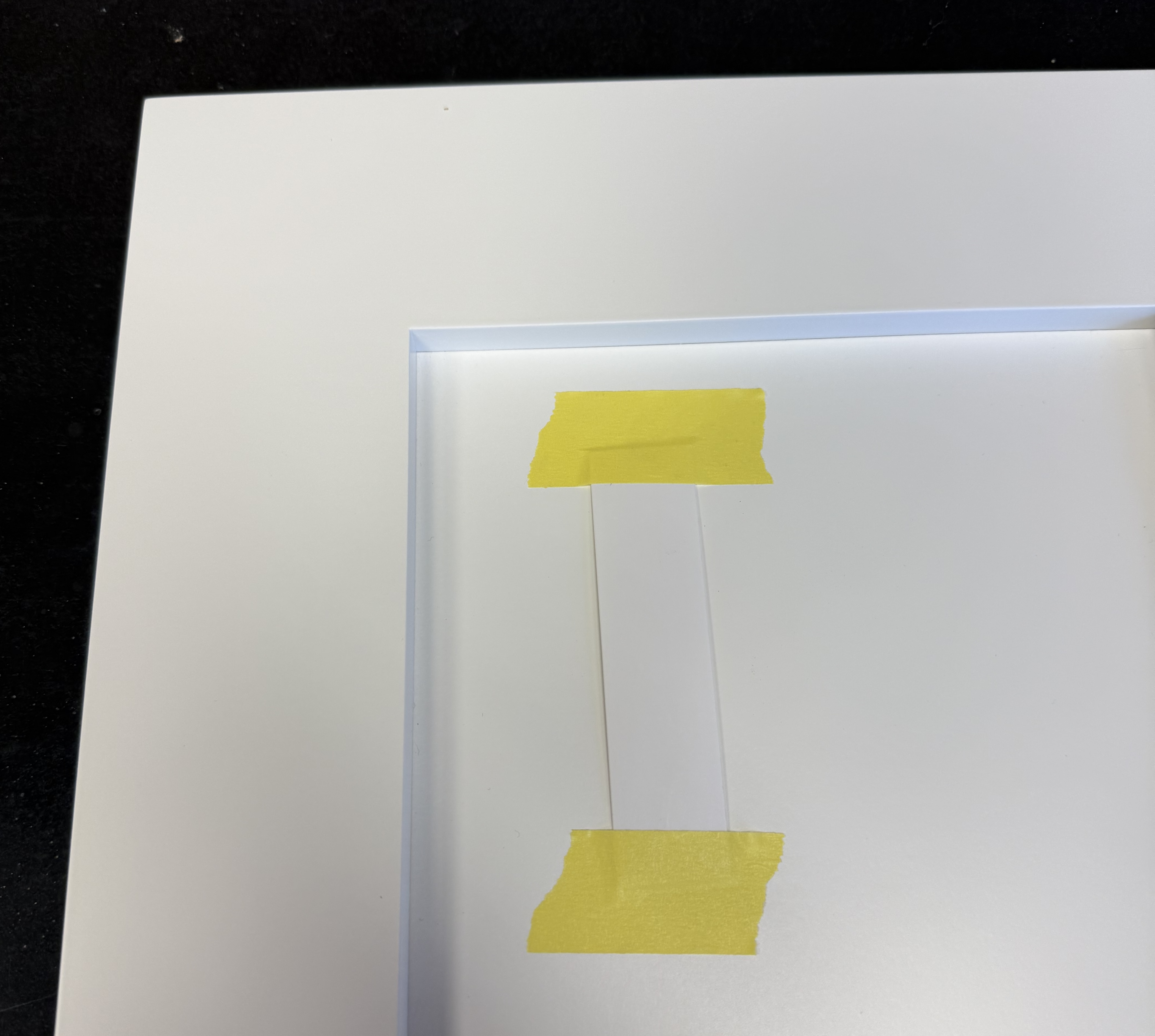

    Is there a link or photos of the PVC edge banding used for the two white CV finishes?

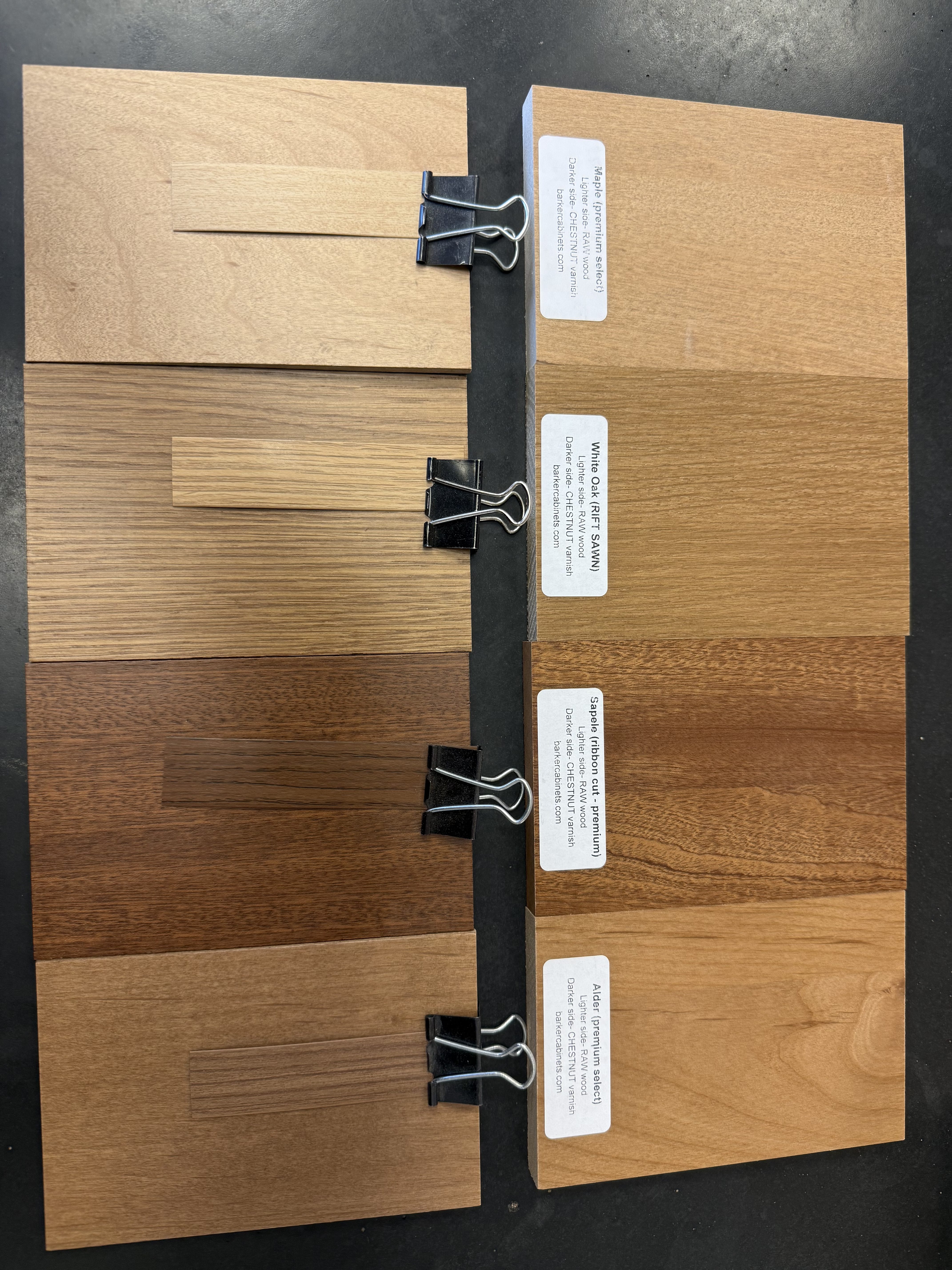

    Also – it sounds like a PVC edge is used for chestnut. If correct, is there a link/photo for that? Is it a solid color or does it have a grain look?

    Sure, see the attached photos here. First is the new Chestnut edge banding showing the grain and color matching. The PVC tape is much more durable than a stained real wood and looks and feels virtually identical to the real thing. Same for the Pure and Dover Whites.

    Is the same white pvc used for both the Pure and Dover? Or are they different?
    January 31, 2025 at 2:32 pm
    The Dover is a bit warmer of a color and has its own edge banding separate from the Pure. They are close in color, but we still change the banding so it has an exact color match.

    On the chestnut edge banding, from your photo it looks like there are slightly different colors of edge banding for the different wood types with the chestnu.
    Are the ones shown in your photo all different chestnut variations?
    thanks
    August 14, 2025 at 2:54 am
    Each wood species will have a different chestnut edge banding selected that looks the closest possible to the final wood color.
