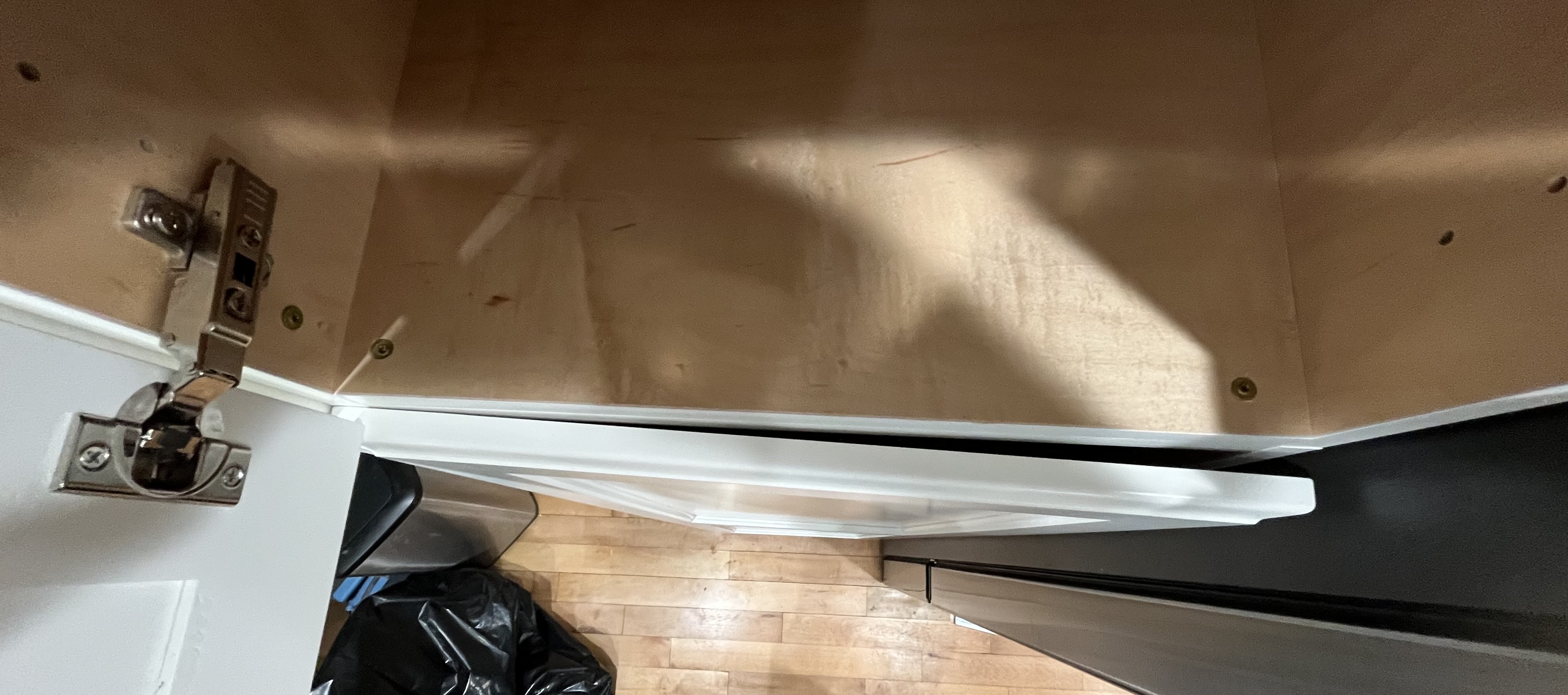

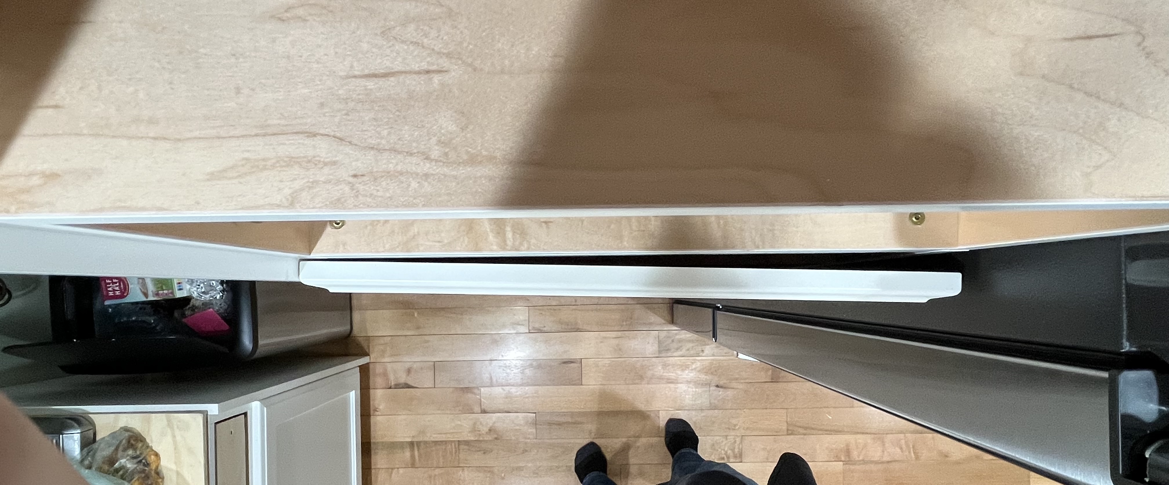

    Hi Chad,
    I’m curious what you think of this door alignment, I’ve played around and get the right hand side to land at the top (it touches at the bottom) like the left hand side does. I have seen the same issue w/my lower pantry door. Attached is a pic to better illustrate.
    Thanks,
    Ken

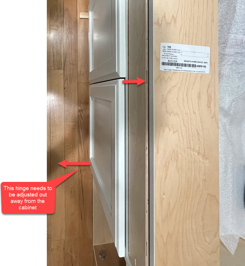

    February 23, 2026 at 11:39 am
    To get the top of that door to sit tight to the face, you will need to move the opposite hinge out slightly. See the attached image for a visual reference.
    If the door is warped more than 1/4″, it can be replaced under warranty. However, it does not appear to be that far out of spec.

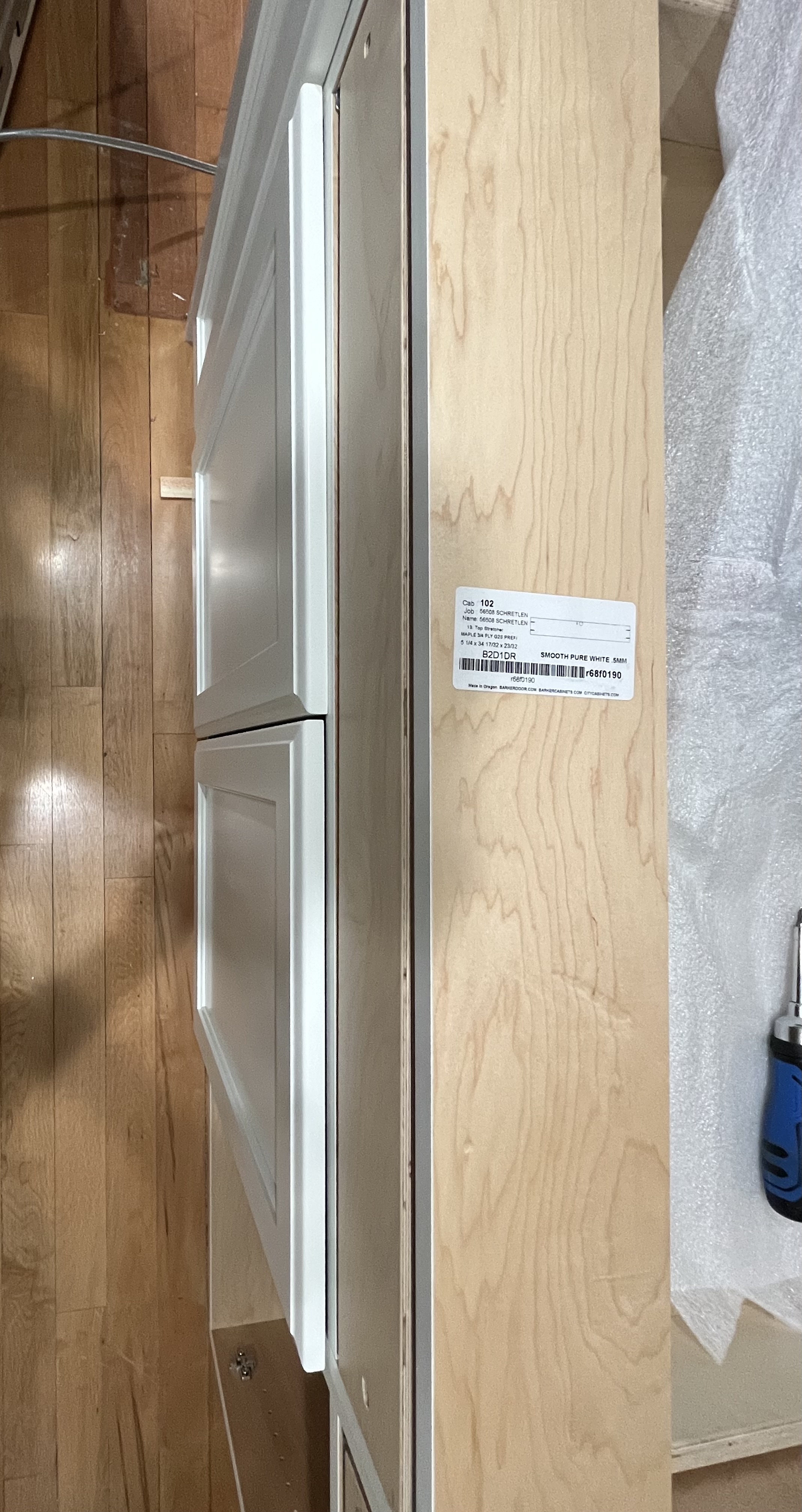

    I have the same issue on my pantry door and unfortunately it already had the bottom hinge fully out away from the cabinet and the top one fully in- I had been playing with all kinds of combinations and finally decided to stop and move on. Now, after fixing the one, this one is not coming together. See attachment.
    Thanks,
    Ken
    February 24, 2026 at 11:24 am
    It looks like the hinges on that door are adjusted too tightly toward the cabinet face. If they are pulled in that far and there is no gap between the back of the door and the face of the cabinet, the opposite side will not close fully.
    Back the hinges away from the cabinet face slightly, then reassess the other side. That should allow you to dial in the alignment more accurately.

    March 1, 2026 at 8:24 am
    Hey Chad,
    Yes I’ve tried quite a bit of changes to the door hinge adjustments, but can’t get it to set properly. Here’s with the hinge end adjusted now as suggested.
    Ken
