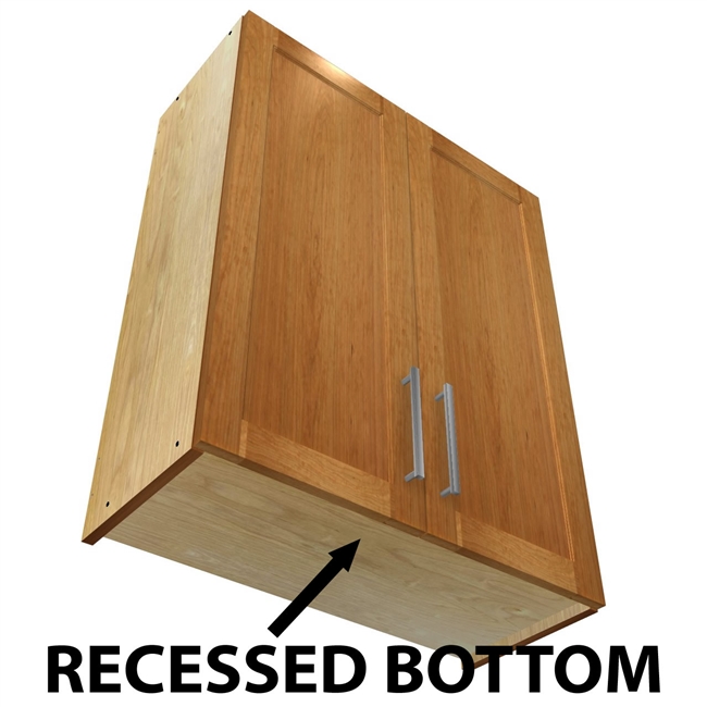

    Apologies for the confusion. I will update the site to show the recess dimension. The depth of the recess is 3/4”. This allows you to cut some of the square trim millwork to size and use it to fill the gap underneath.

    Thanks. That was my assumption, and it is inferred by the mention of the light valance trim, but I think it would certainly benefit to have it called out specifically somewhere in the description. Great addition to the product line, in my opinion. It works out perfectly for the kitchen we’re currently working on with three wall cabinets all separated by open space or an over the range cabinet. Our previous project with you back in 2024 has contiguous wall cabinets, and we have yet to install the light valance we ordered through you 😁.

    Pic added.
