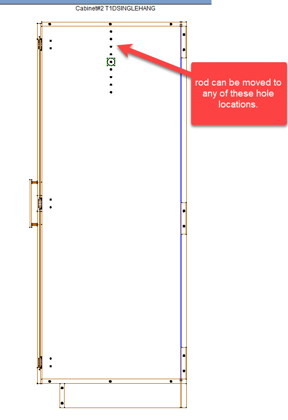

    4. On the Wardrobe style cabinet, there is a hanging rod. It looks like the rod is inserted through a pre-drilled hole. What is the height of the rod placement, and is that adjustable? Alternatively, can we have the cabinet not drilled for thee rod, but the rod still provided?

    4. All of our closet rods are fully adjustable. We install them in a default position near the top of the cabinet, approximately 3 inches down from the top. After installation, you can easily lower the rod as needed with minimal effort. See below for a side view of a tall single hang cbainet:
