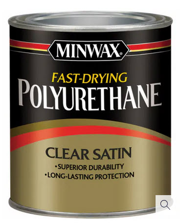

    Our clearcoat is a conversion varnish (solvent based) finish that is not available to the general public. It is an industrial finish that must be sprayed using ventilators in a heated spray booth environment.
    To get a close match to our product, using a clear satin Minwax poly is a very durable finish that can be easily applied on site and wil match up rather well.
