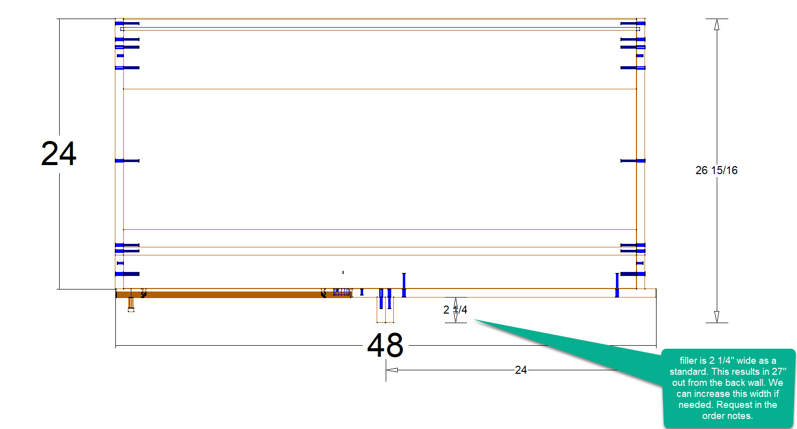

    I have a difficult corner in a small kitchen which I’m trying to maximize storage space. I have a total width of 30” to work with next to a built in fridge The only thing I can find that works is a blind cabinet with a large filler. Is it possible to order another style such as the 90 degree base with a 30” width/depth and 24” returns? I was able to get close with the wall cabinet but the return options were limiting.

    A 30″ x 30″ base 90° module would be too small for the hinges and doors to operate correctly. It would also provide an opening that’s too limited to be useful for storage. I recommend using a blind corner cabinet in that area and allowing the filler to span the 6″ wide gap. We can certainly increase the width of the filler on the face of your blind corner cabinet, as long as this is noted in the order comments at checkout.
  • Mike
    April 8, 2025 at 6:18 am
    Thanks, the drawings are very helpful. that’s the option I was trying to avoid but looks like the best choice.
