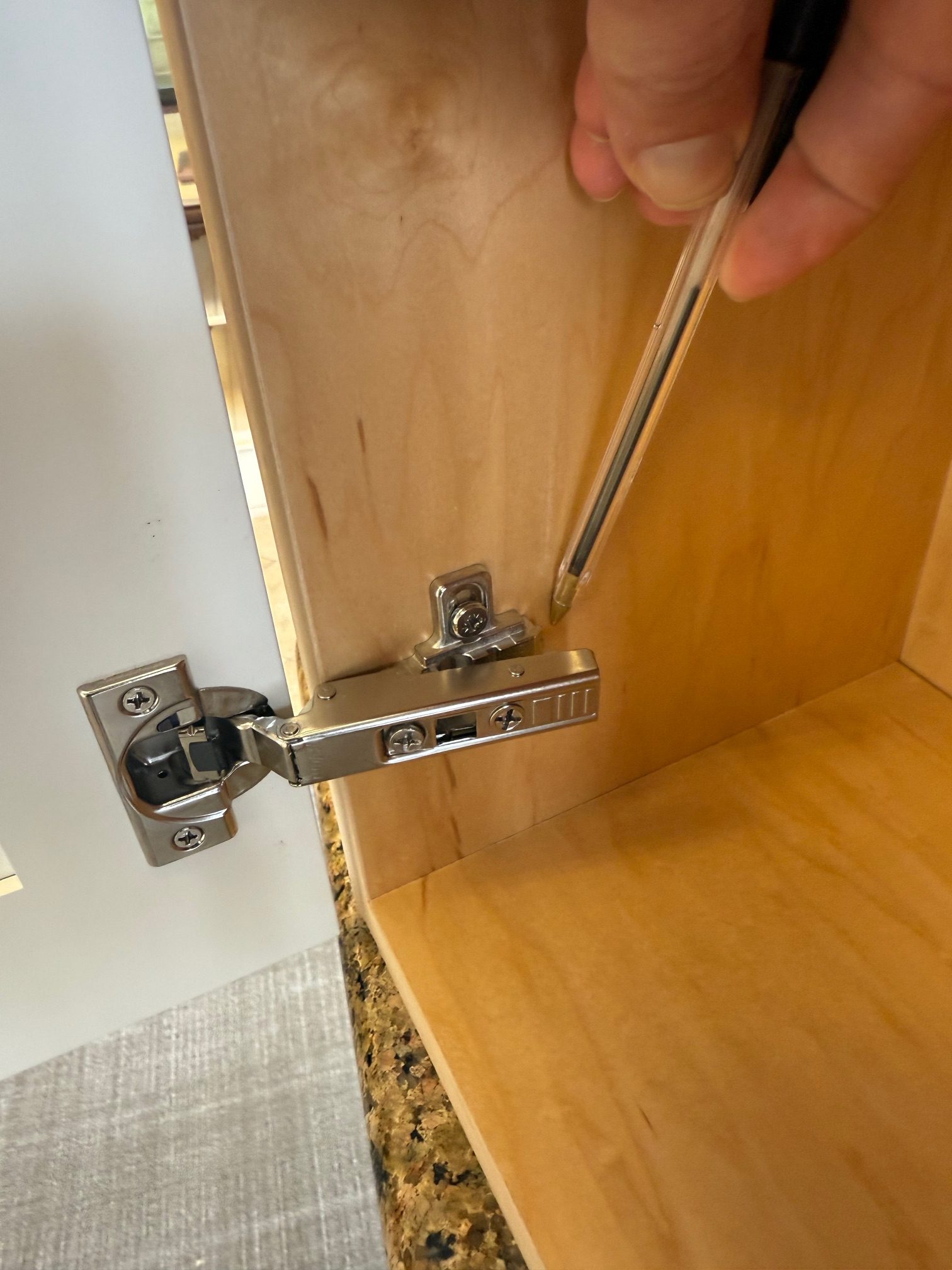

    Sure, there are several ways to hide the screws if you truly don’t want them visible when opening the cabinets. Personally, I find that the screw locations are usually discreet enough that it doesn’t bother me to place them next to the hinge plates, on the hinged side of the cabinet toward the front. With a bit of extra effort, you can even hide the screw under the hinge arm itself.

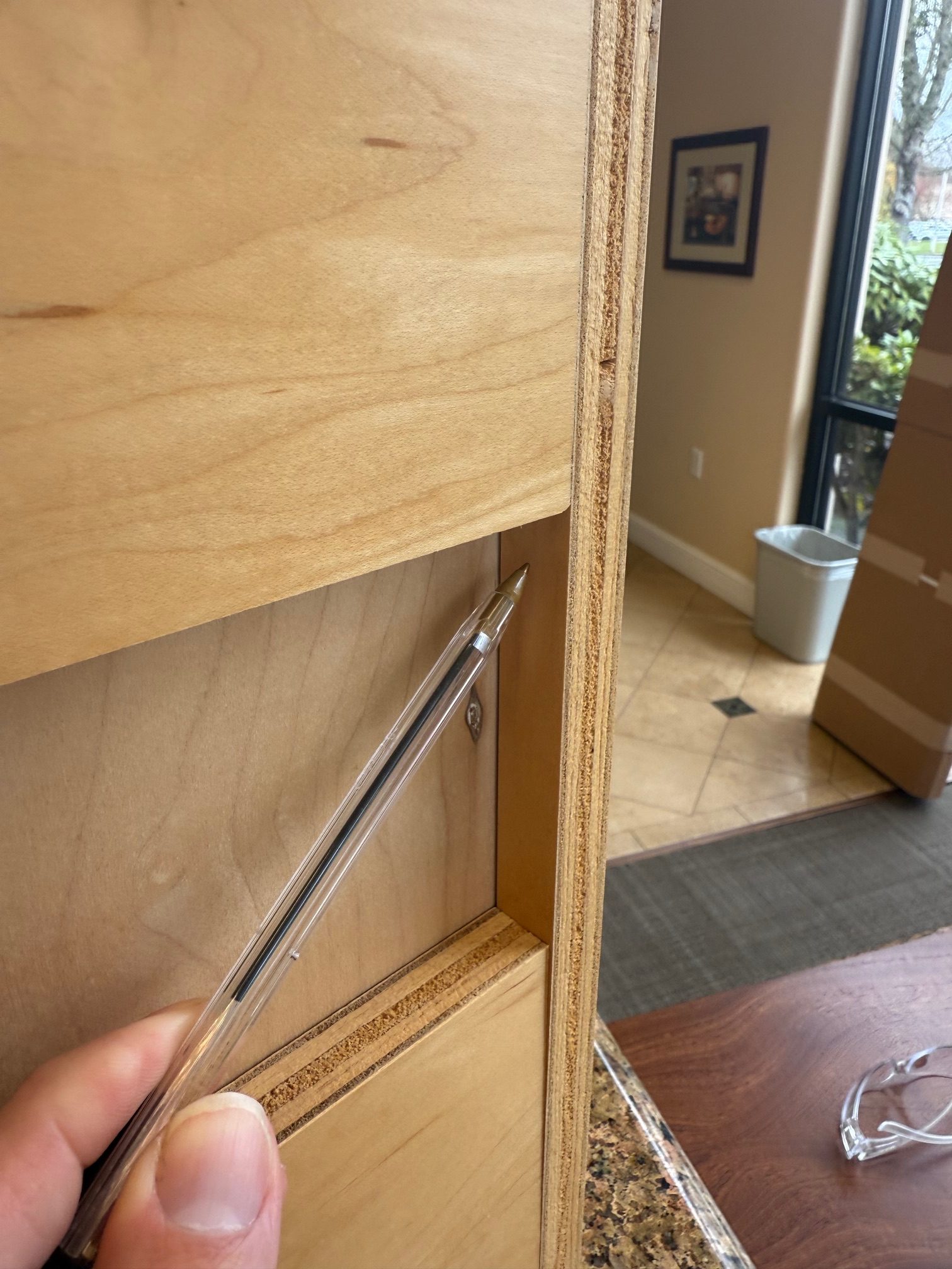

    For drawer cabinets, you can tuck the screws under the slides. That said, it’s usually not a big concern since the drawers tend to block the interior view anyway.
    As for the rear support screws, you can conceal them behind the cabinet back, underneath the rear stretchers. Keep in mind that this makes it nearly impossible to disconnect the cabinets from each other once they’re installed on the wall—but the screws will definitely be hidden from view.
    When attaching cabinets to wall studs, the quickest way to conceal screw heads is by using matching FastCaps. Alternatively, you could use a more decorative cabinet screw with a large pan head. I’ve seen both approaches used, and either one can look good.
