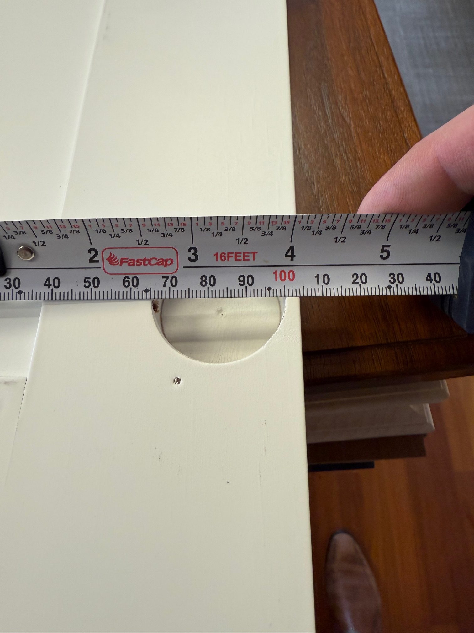

    What is the offset dimension of the cup from the edge of the door, typical dimensions are 3 to 7 mm. What dimension do you use
    Chad replied 1 year, 9 months ago 1 Member · 1 Reply
    January 10, 2025 at 11:20 am
    Hinge cups are drilled with a 3.5-4mm tab.
