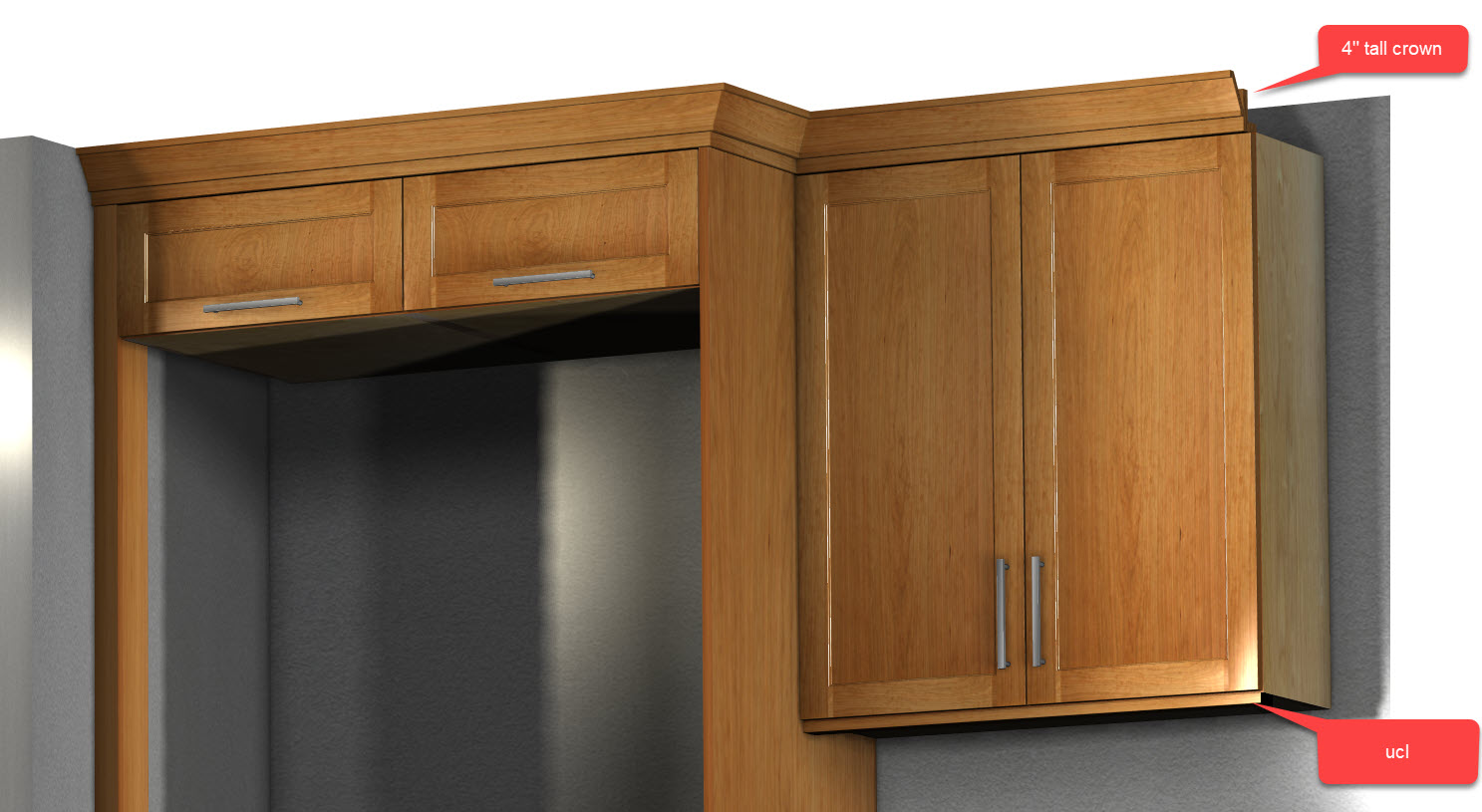

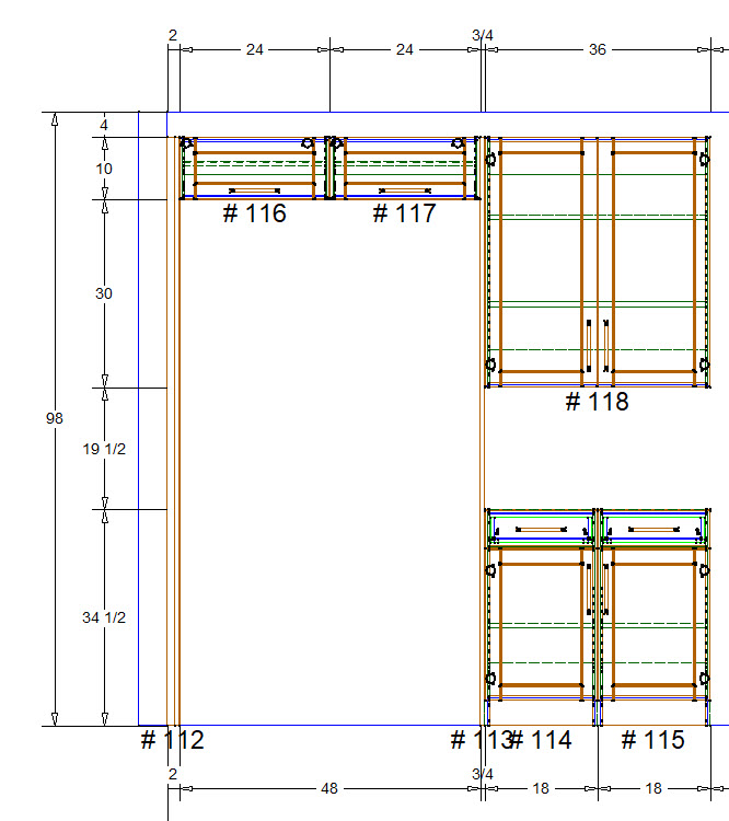

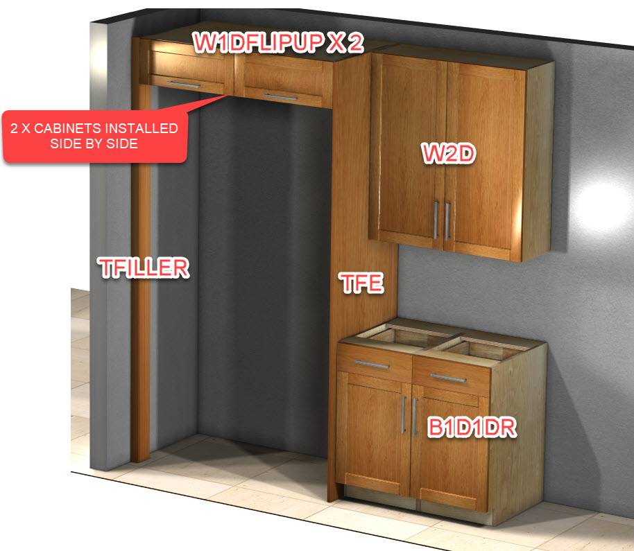

    Sure, fairly simple, I would recommend a flip up door cabinet here. Likely your REF will be 48″ wide, or if you have two columns, they will combine to be a total of 48″ wide. This is too wide for a single 1 door flip up cabinet as the doors would be almost 48″ wide and very short. Instead, you would need to break that upper into two separate flip up cabinets. See pics.
    Note that the flip up lift cabinets are not available at lower than 12″ in height. Since these cabinets are so high up in elevation. I would suggest just getting some regular non-stay-up door cabinets as there is little need to regular access to these areas. They are really only there for looks and occasional holiday storage.
