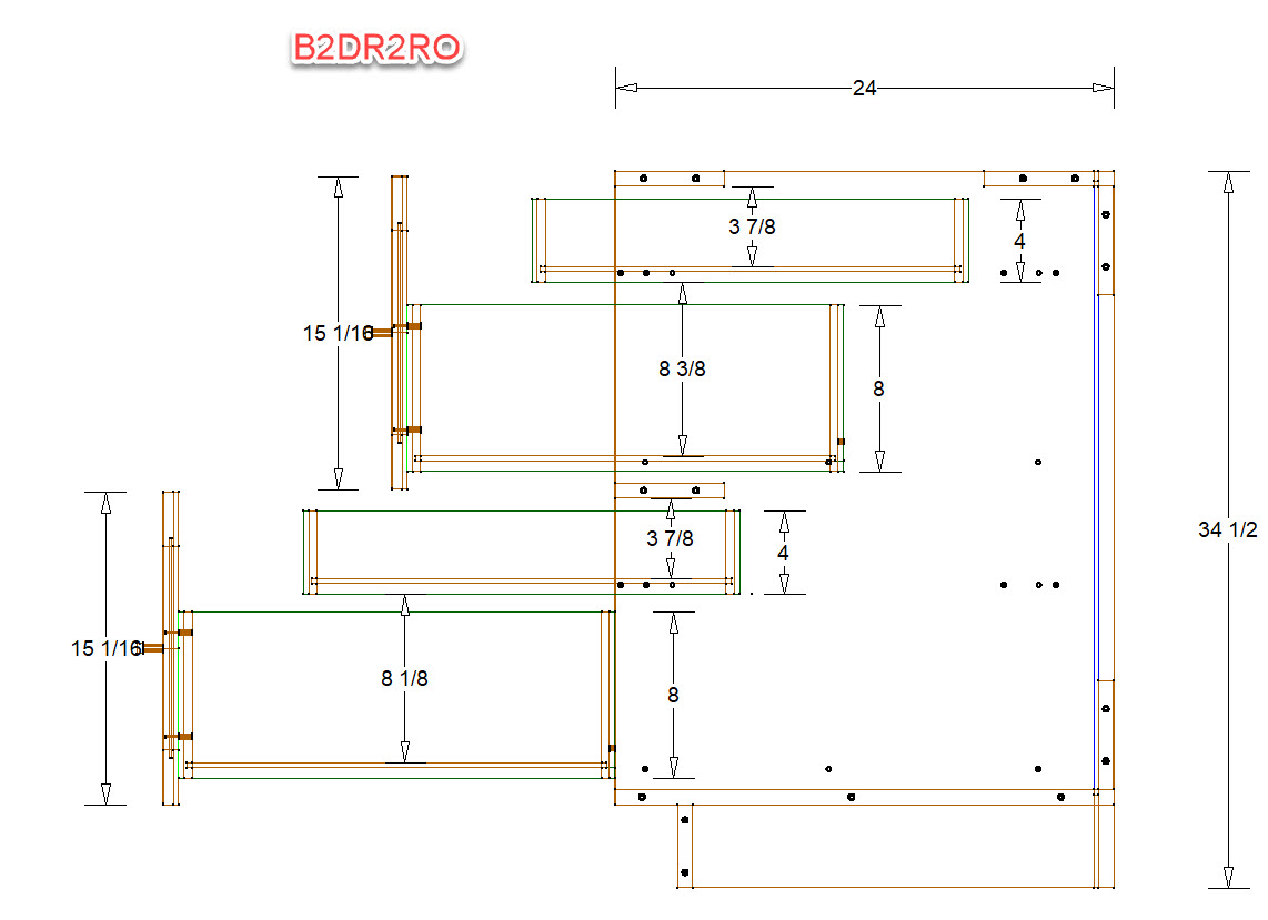

    I am looking into using cabinets B2DR, B2DR2RO and have a few question: When B2DR is configured for slab front do both drawers get slab fronts? what are the internal heights of each drawer? When B2DR2RO is configured for slab front do both drawers get slab fronts? Can B2DR2RO cabinet be configured such that there is no hidden rollout for the bottom drawer? What are the internal heights of the drawers and the rollouts? Do I use B2DRTALL in Chief Architect for these cabinets?

    Yes, so long as you order the “door and drawer fronts” style as “slab plywood”, then all the fronts will be slab/flat.
    Sure, see the attached images for a side view of each cabinet.
    To get a 2 drawer with only the top rollout, you would need to order the B2DR and request that a custom rollout be added to the the top opening in the order notes at checkout. Attempting to delete a rollout would cause paperwork issues if we added that request to the B2DR2RO.

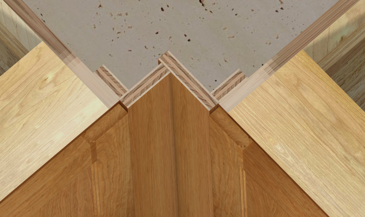

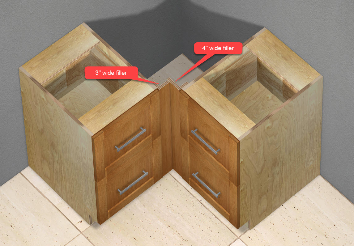

    You need a minimum of 3″ in the “dead corner” to allow the filler widths to provide proper clearance for drawers and any hardware that may protrude from the drawer fronts. Here’s a picture showing how I would handle an inside corner like this.
    Basically, you would order a 4″ wide filler and a 3″ wide filler. The 4″ filler allows the 3″ filler to butt into its face and be screwed in from the back, creating a very stable inside corner. You can then attach the assembly to the base cabinets from either the interior or exterior.

    June 13, 2025 at 6:20 am
    Thank you! These pictures are extremely helpful to understand and incorporate in the design. Very much appreciate the assistance.
