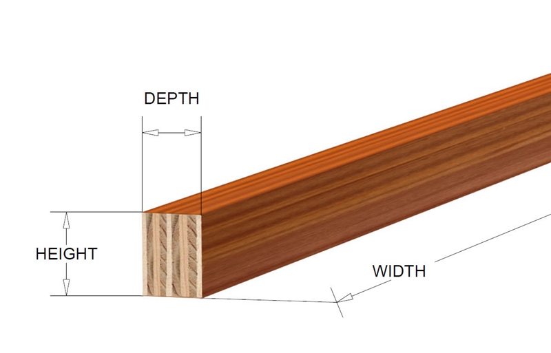

    The 4″ strips can be ordered using our custom rail product. The top and bottom edges are finished, leaving only the ends exposed. Since the ends will be covered in your application, this should work well:
    https://www.barkercabinets.com/product-p/mrail.htm
    The rail is limited to 6″ for the height. If you need an 8″ piece, the best option would be a standard finished end panel or an appliance panel ordered in the slab plywood door style. Either option will provide the same finished result:
    https://www.barkercabinets.com/Appliance-Panel-panel-used-on-face-of-appliances-p/appliancepanel.htm
    For the crosspiece, I would use a 1.5″ thick finished end panel or similar product. This creates a clean stopping point for the 4″ wide, 3/4″ thick strips and gives the upper section more depth. It will also be much stronger for mounting coat hooks.

      So I just priced out the 8″ deep 54″ TFETHICK, and it’s $674.95 (in Cherry, clearcoat)! So regardless if the TFETHICK is 6″ or 26″ deep, it’s the same base price?
        July 30, 2026 at 3:17 pm
        We really need to add a rail product that uses our 1.5” thick plywood. Since this material was only added to our inventory relatively recently, we haven’t had a request for it until now.
        The challenge is balancing the size and weight of the material with FedEx Ground oversized shipping charges. FedEx calculates these charges based on both package dimensions and weight, so we have to account for those costs when pricing certain products, especially long or heavy parts.
        Even if your order ultimately ships by freight, we still have to factor in the risk of shipping damage. If a long, heavy part is damaged in transit, the cost of manufacturing and shipping a replacement can be significant, which increases the base price of these items.
        I’m going to put together a sample using the 1.5” material and see if we can develop a rail product that makes sense after running a shipping quote with packing material done as needed. The main challenge will be determining the maximum practical width and length for a 90” millwork blank, then calculating the lowest price we can offer while still protecting against the added shipping risk. 6” might be outside that range.
