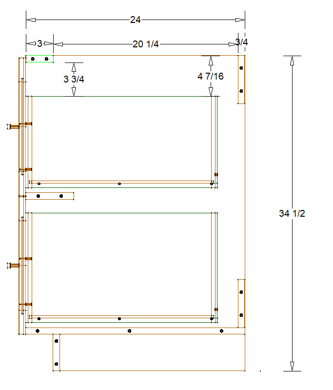

    Hello. For the 2 Drawer Cooktop base that is 30”wx24”dx34.5”h (B2DRCOOKTOP), what is the depth of the top front stretcher? Thanks
    Chad replied 6 months, 2 weeks ago 1 Member · 1 Reply
    March 30, 2026 at 12:11 pm
    Sure, see the side view here. Note that you can cut into the rail to free up space and bring the cooktop unit forward. The rail is there to help keep the cabinet square and provide some support for the countertop.
    Some countertop installers may add additional bracing if the stone is not strong enough to span that area, but that is typically determined by the installer on site.
