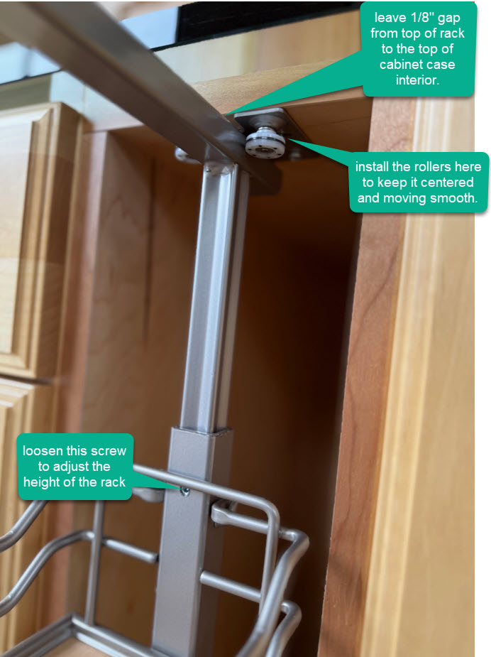

          Did you reduce the cabinet height on site during installation? Our cabinets are fixed at 34.50″ tall, as shown on our product page.
          https://www.barkercabinets.com/product-p/bhafelebasepullout2slim.htm
          If you reduced the cabinet height to 34.25″, that’s perfectly fine. The pullout slim rack includes Allen-wrench set screws that allow you to adjust the height up or down by a few inches to accommodate variations. The rack should always be installed directly on the cabinet deck, without any additional 1/4″ fillers underneath.
          I don’t see a reason for adding a filler, but if one was used, you’ll need to modify the vertical position of the door drilling pattern by 1/4″. Alternatively, you can drill a new set of mounting holes 1/4″ up or down on the back of the door—whichever provides the best fit for your installation.
