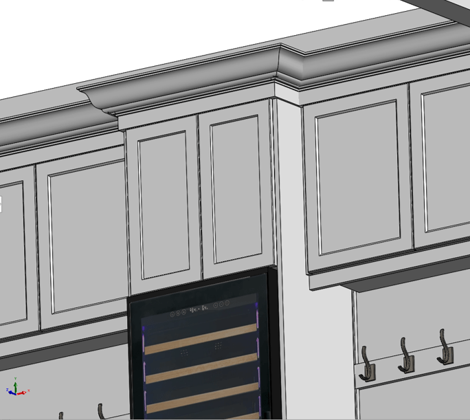

        Hi, I have an inside corner that is created by an 18-inch-deep refrigerator panel transitioning to a 12-inch-deep wall cabinet. I’ve added a 3/4-inch filler between the refrigerator panel and the wall cabinet. Is this enough to ensure that the door on the wall cabinet will open a full 90 degrees?

          It’s perfectly fine for the wall cabinet to butt directly against the finished end panel of the tall cabinet stack without adding another finished side panel. The zero-protrusion hinges we use are designed specifically for this type of installation, allowing wall cabinets to sit flush against a tall finished panel without interference.
